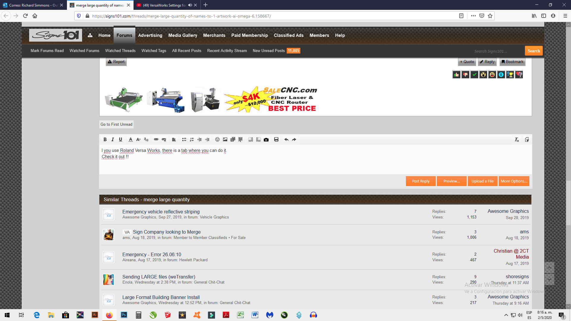

I you use Roland Versa Works, there is a tab where you can do it.
Check it out here:
