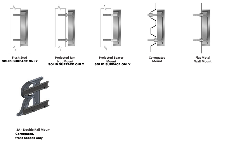

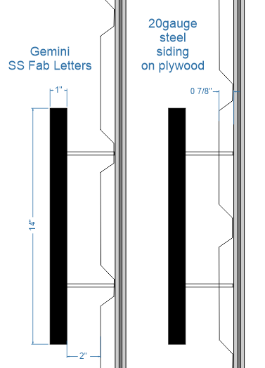

I'm installing 14" stainless fabricated letters w/ closed backs 1" deep plus 2" spacing. Putting the studs in the valleys seems like it makes more sense, but will it make the drill template much harder to use? Drilling on the peaks I just need to keep the drill square. I might be overthinking this
