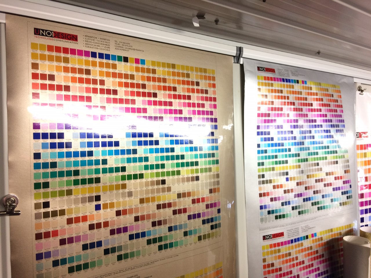

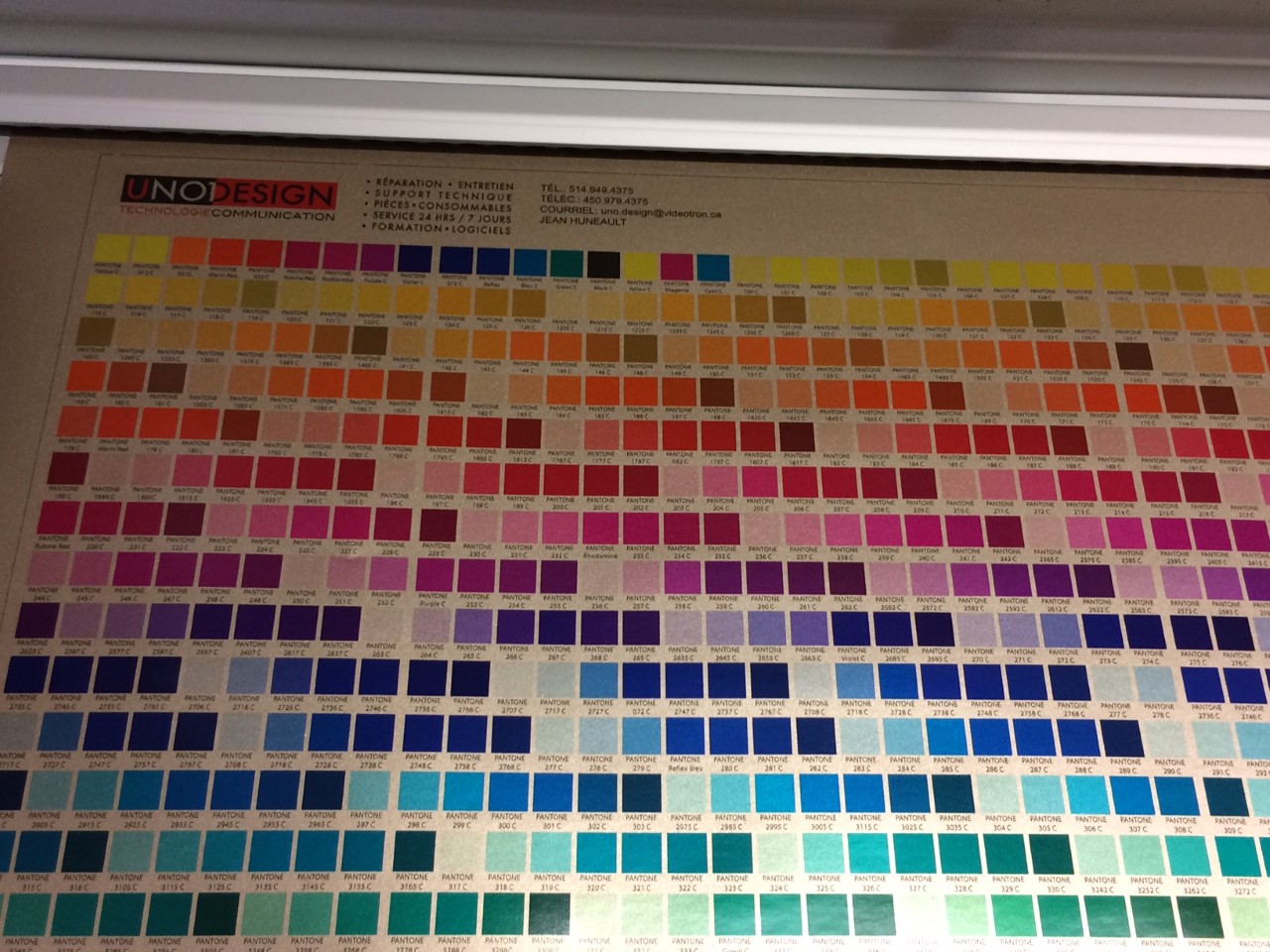

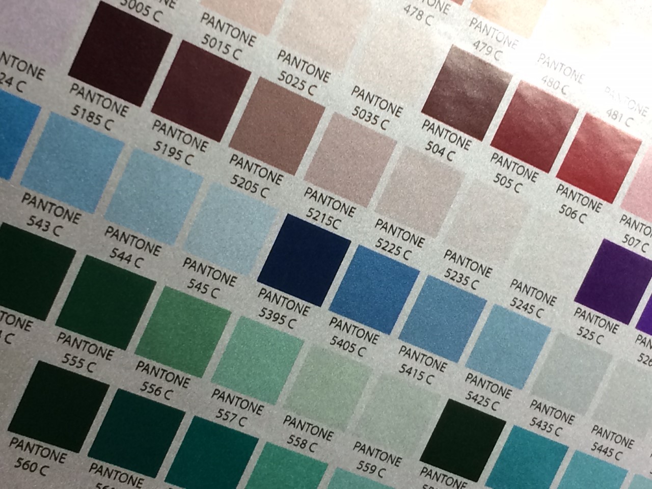

I do a lot of semis striping. I print on cast metallic films every weeks w/o a single issue, not even at cutting step. My Roland find the marks as it was on white. Our inks are translucid meaning you can see the metal flakes through. I have a VG2-540 (with orange). Printing on silver or gold means your colors will show up darker (red -> dk. red) but no big deal.

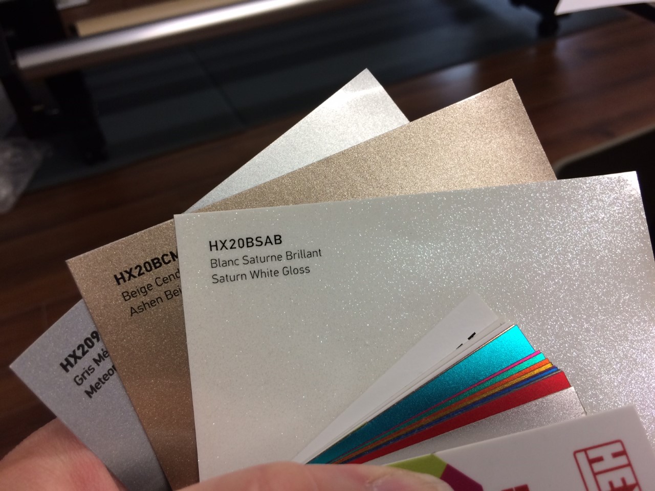

I use 3M/Gerber 220, Oracal 751 and any of the colorchange wrap films I want. Today I have printed on a very nice film from Hexis called Saturn White (HX20BSAB) which is a white metal flake (coarse flakes) and it creates amazing metallic colors. I always laminate with 3M 8518, whatever the film's brand under it. I do this for a long long time (time tested). Sure you can use the 3M ij180-120 which is a real printable film but you pay more for nothing (except it's a Comply ControlTack... easier for bigger pieces when going cowboy (dry). I can't tell for other brands / ink set but my Roland with OEM TR2 is amazing for that kinda jobs. Oh BTW, I always print bleed... let it dry for 24h and you're good to go.
Patentagosse
Here's few shots
