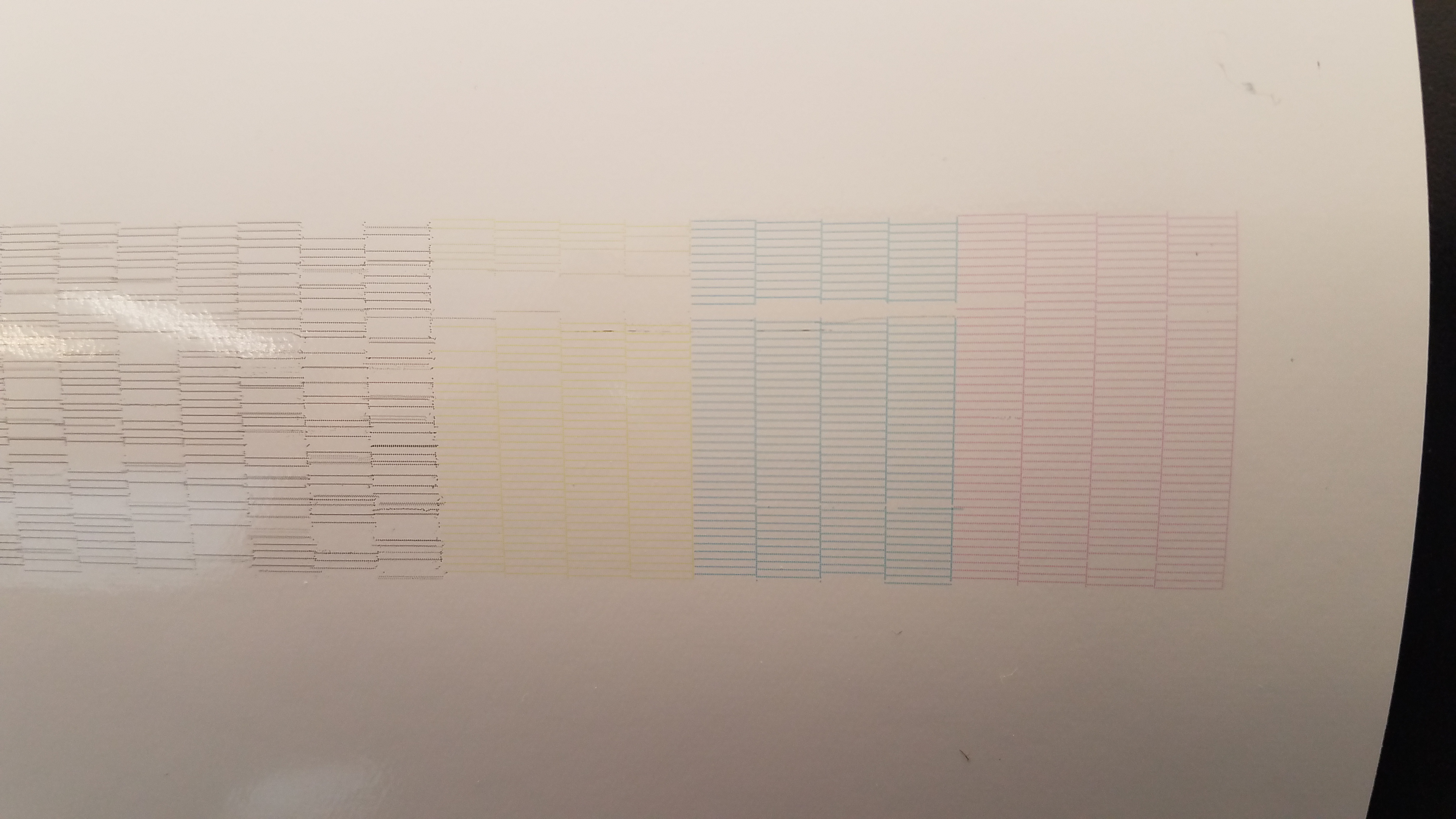

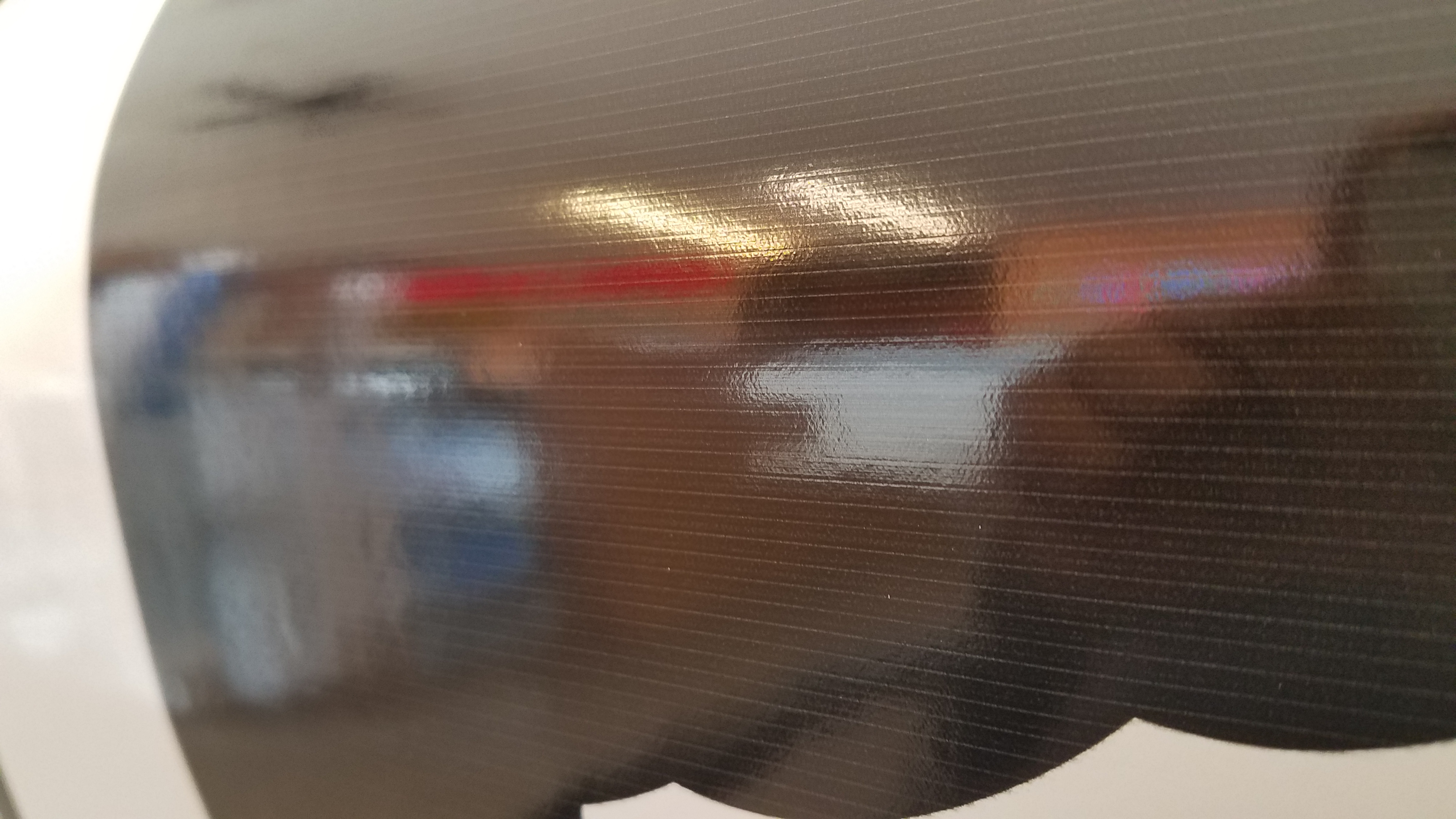

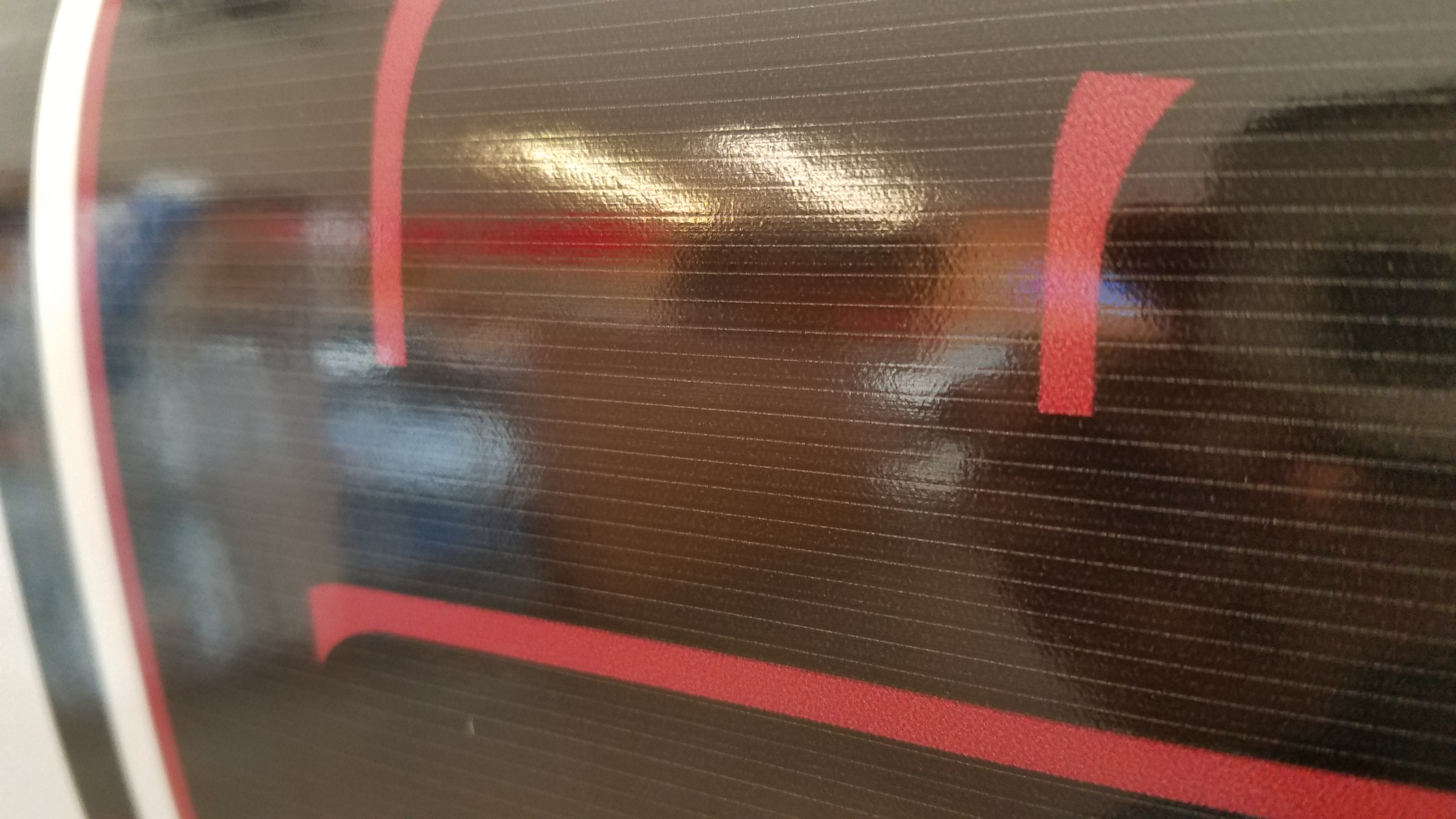

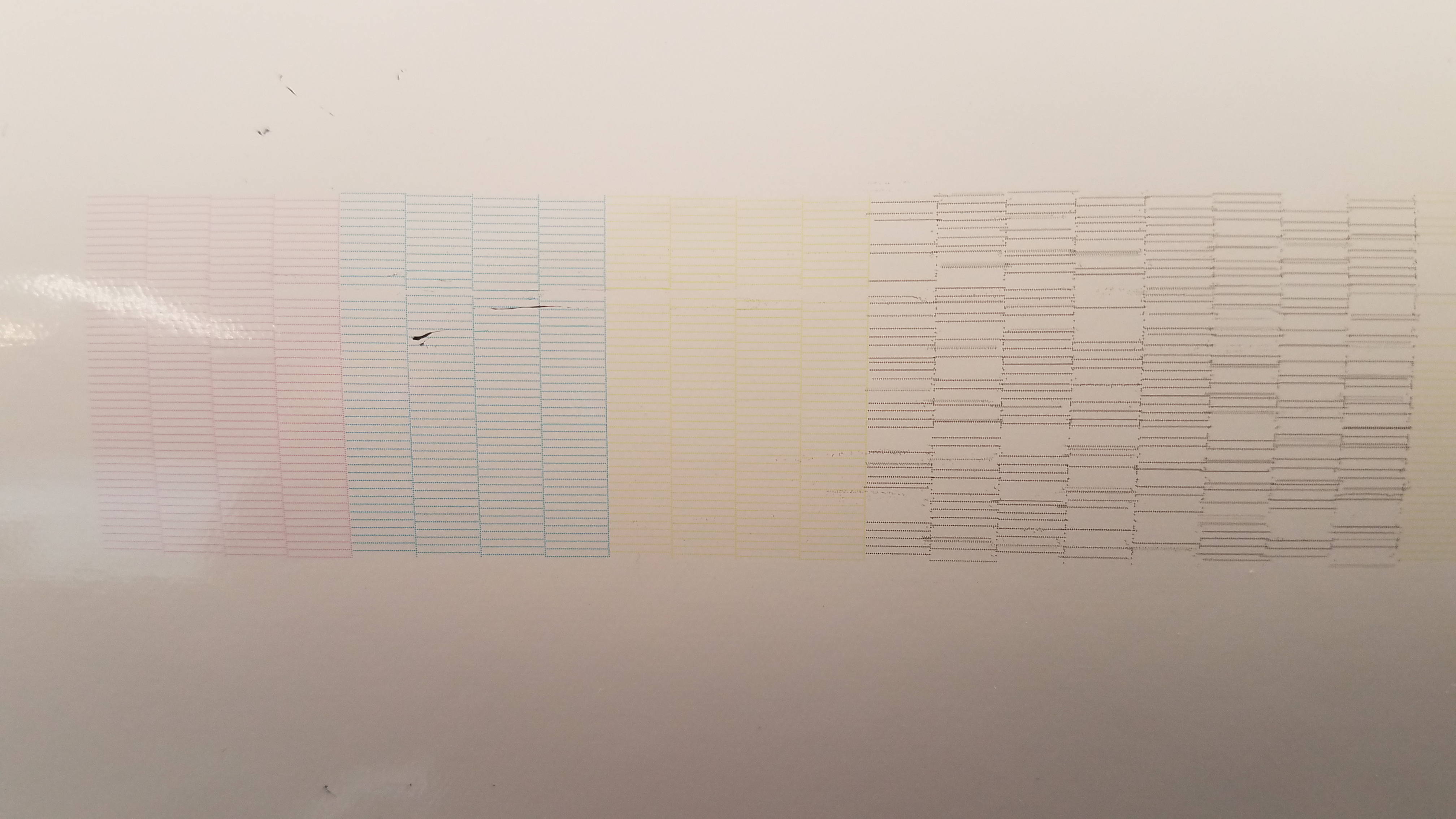

Hi folks, I am having a bad banding issue with my Mimaki CJV30-160. I have done all the cleanings, multiple times, nozzle wash, the whole nine yards. I am using OEM inks, with the original print head (about 7 years old now. I am posting a few pics of the print test, and a couple of the banding pics. Its only really happening when I print solid black areas, the color areas seem fine. Just want to see if you folks have any suggestions for what the issue might be.
Thanks in advance for any help!

Hate to be the bearer of bad news, but it's time for a new head. I have a CJV30-130, and it was way better, and it was my head. Didn't realize it, but the tech said the whole machine is supposed to be fully serviced like every 18 months. Oops. Anyways, only got 4 years out of my head.

Ok, maybe a little more info here.
I ran a print this morning that was just red and blue (it used a tiny amount of black for the dark blue), it printed fine.
Ran a test black print afterwards and got the bad banding.

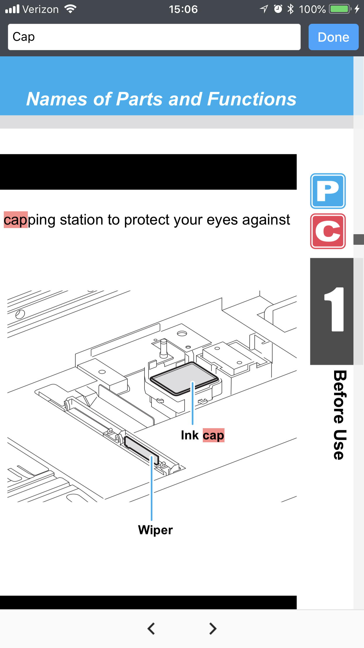

Ok so the capping station is on the right side where the printer head sits in like when it self cleans. It’s a black square plastic piece.
