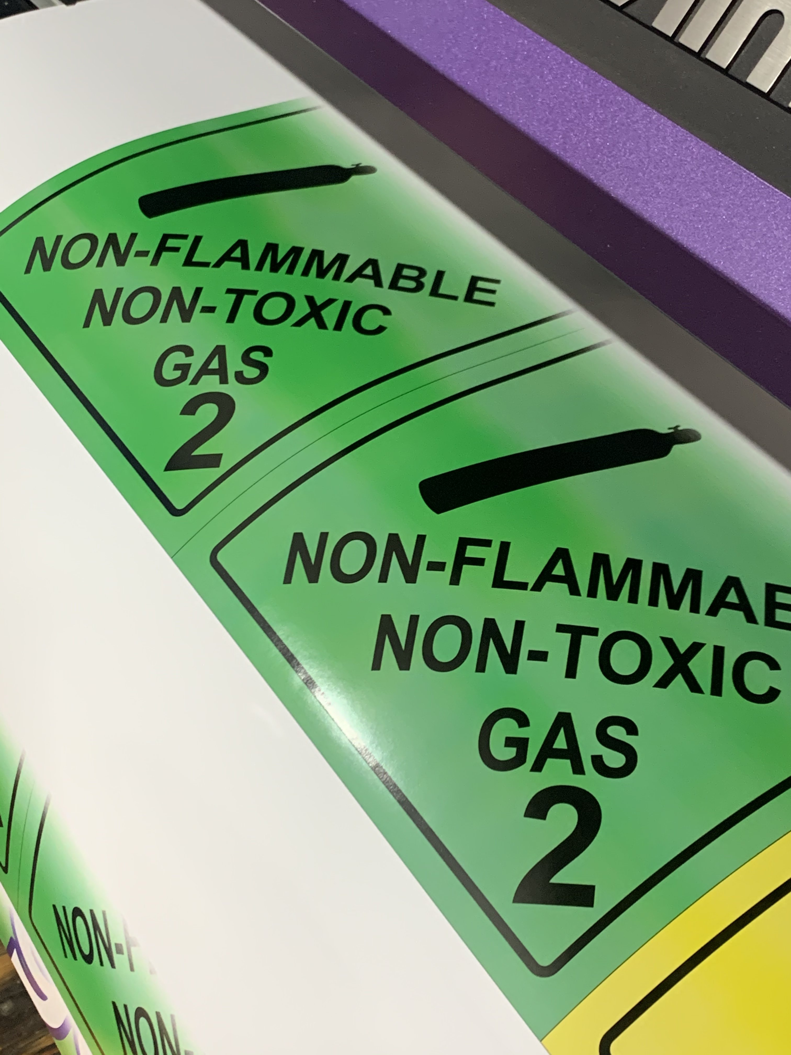

Hi all, I’ve recently had trouble with the print quality in my Mimaki CJV300-160. Machine is 14 months old. It has printed fine and now looks like there are colours dropping out here and there. All test prints are perfect, ie tried different types of media, files, And new inks. Nothing is helping. Any help and suggestions would be greatly appreciated.

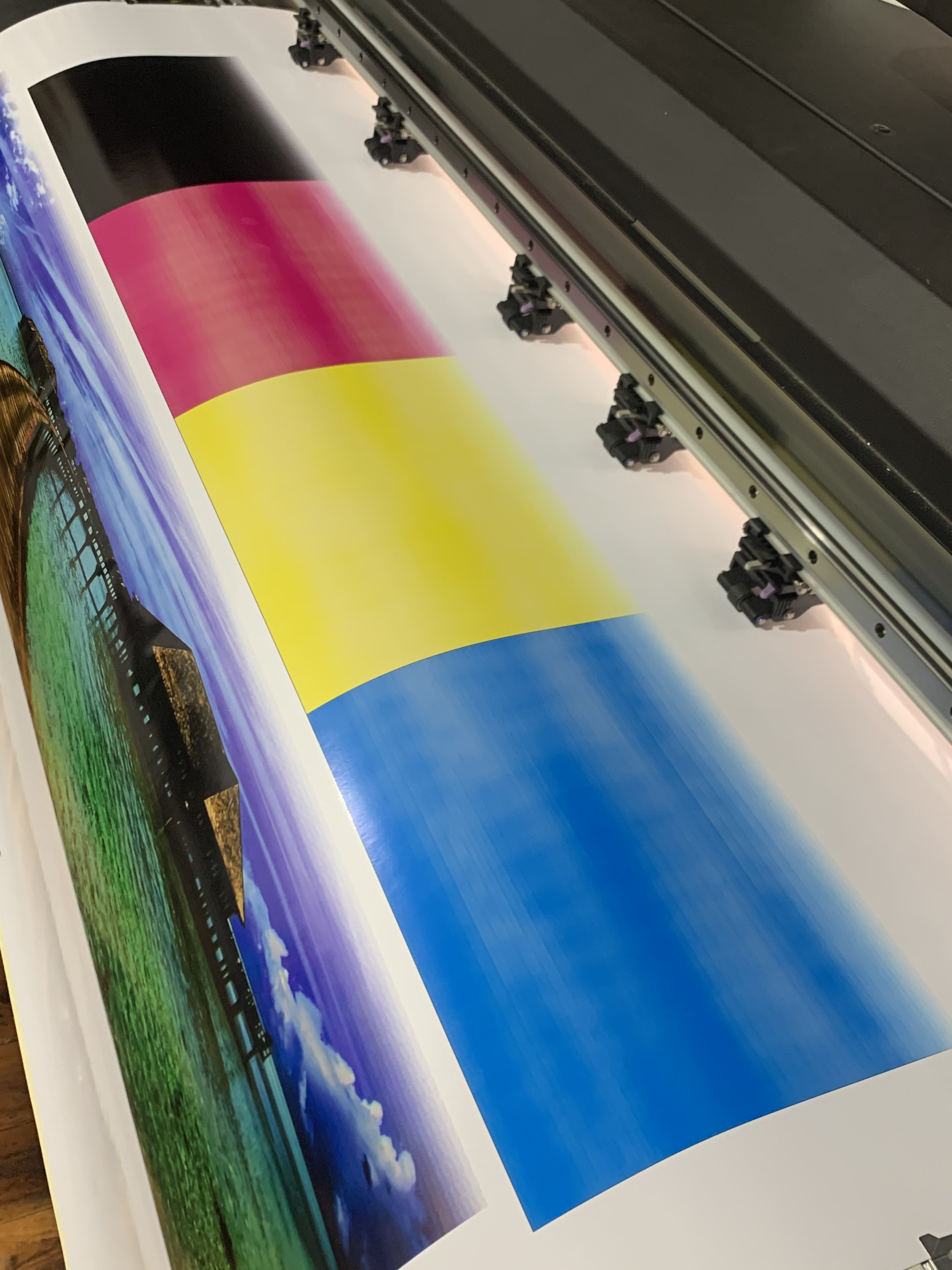

Hi thanks for your response, head alignment is perfect, CMYK blocks are as photo attached shows. I’ve printed this several times and sometimes it will nearly all be ok then others it starts fine then drops out and then comes better etc etc. Printing undirectional doesn’t change anything either. I have spoken to a tech today but he’s not sure when he can get to me as I’m a few hours drive away but it has him stumped also. Even when it appears to drop out I can do a test print straight away and all heads/ nozzles still print perfectly.

It cannot be ink starvation since unidirectional should give plenty of time for the ink to get to the head but as far as I can see only blue and magenta is affected which is on one head (if my memory serves my well). Looking forward to see what the technician says.
