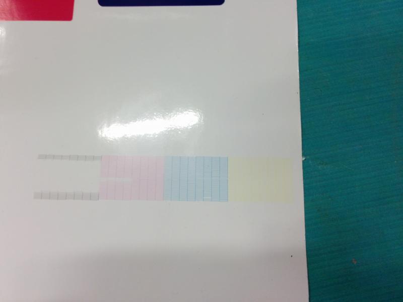

I have a mimaki JV3-160SP. The black nozzle seems to be partially clogged. I'm working on getting a good photo of the heads (kind of hard to get in there with a camera) but attached is a photo of a test pattern.

Whoops, forgot to attach the test print. Should be attached now.

It looks like your magenta was already damaged by the capping station screws, and I'm going to go out on a limb and say the black is too and now it isn't even sitting down on the cap correclty resulting in an incorrect seal and nozzles not firing. Replace those screws with flush mount screws (take out one of your screws and go down to your local hardware store) asap and TRY doing the head flush/push/pull; but get ready to call the tech out to put in a couple new heads. :(
