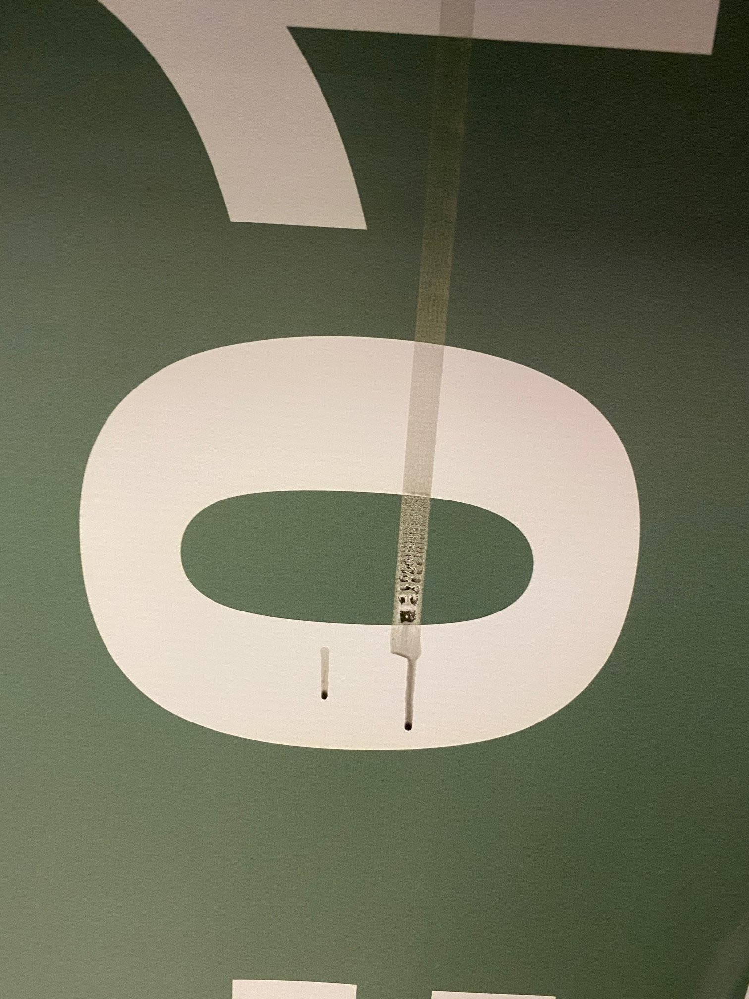

Hi guys, wonder if any of you can cast your mind back, i have a JV3 thats new to me, but mint condition for it being a 2006 model, its been used as a second production printer all its life and been serviced regularly.
Anyway i got it last September, and this week the cap tops where looking like they had been on from new lol, so i put a new full cap housing in as the pumps are on the back of this machine and it was easier, and when firing back up and doing a test draw, very randomly when printing a drop of black ink drops on the surface of the substrate and then the rollers run through it, it seems way further back than the print heads, and i cant work out where its coming from, i changed the two black dampers as they looked a bit suspect, but its just done it again, see image below
any help would be really appreciated on this, im hoping its not the black head on its way out, as i cant be bothered to strip it down again.

just to inform you i think ive fixed it like i said i just changed out two of the dampers on the black head, and now it isnt dropping anything, i had a feeling it could have been those.

I think the tube that leads from the cartridge to the dumper is leaking somewhere possible on connection that is connecting 2 tubes together and flows down on the vinyl. Its not on the dumper because rollers are way behind print heads problem is somewhere behind the rollers

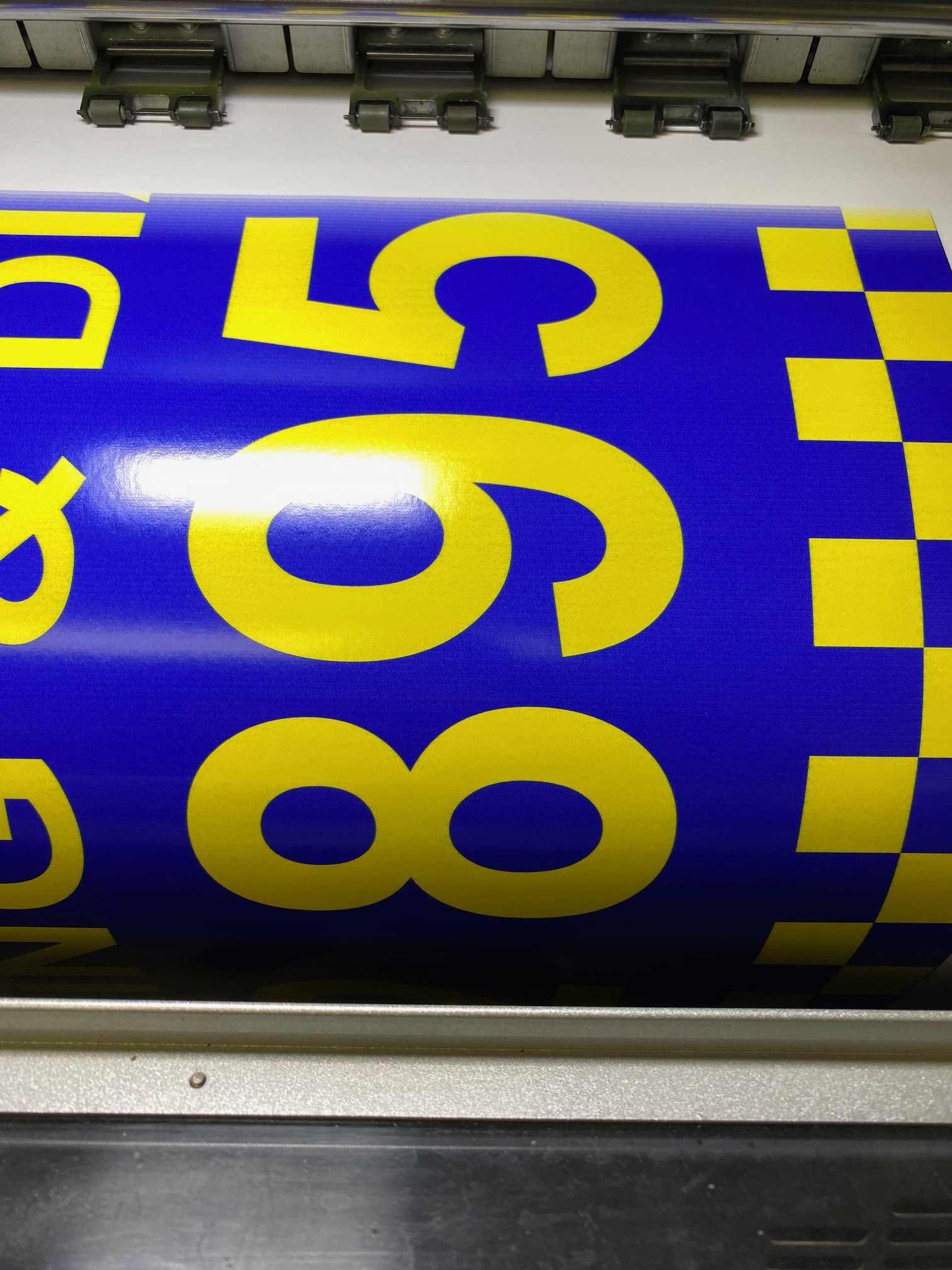

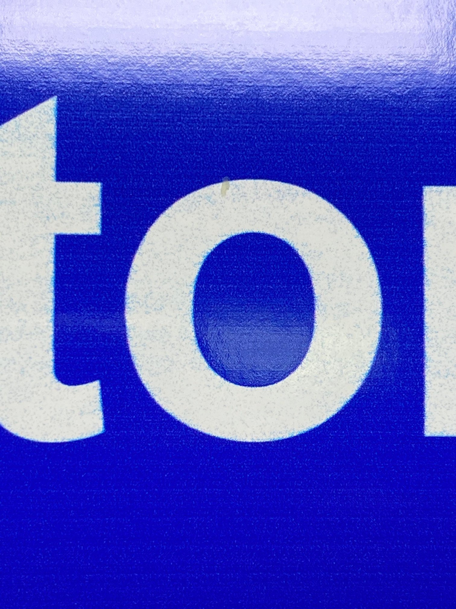

Well thanks very much to DrunknMonk Gary for the spare parts i got today, changed the firwire board and set about aligning the new head everything is printing great, except for yellow and cyan seem to be streaking across one another, cant work out what it might be, ive cleaned all the heads manuually and aligned them, whipped up the temperature a bit to see if thats it, but its still there see photo any any ideas please

Crikey sorted it again, Head cables on Cyan head must have been on there way out, the dots on the alignment marks were all over the place, so i thought that may have been it.
Blue and yellow are clean again
