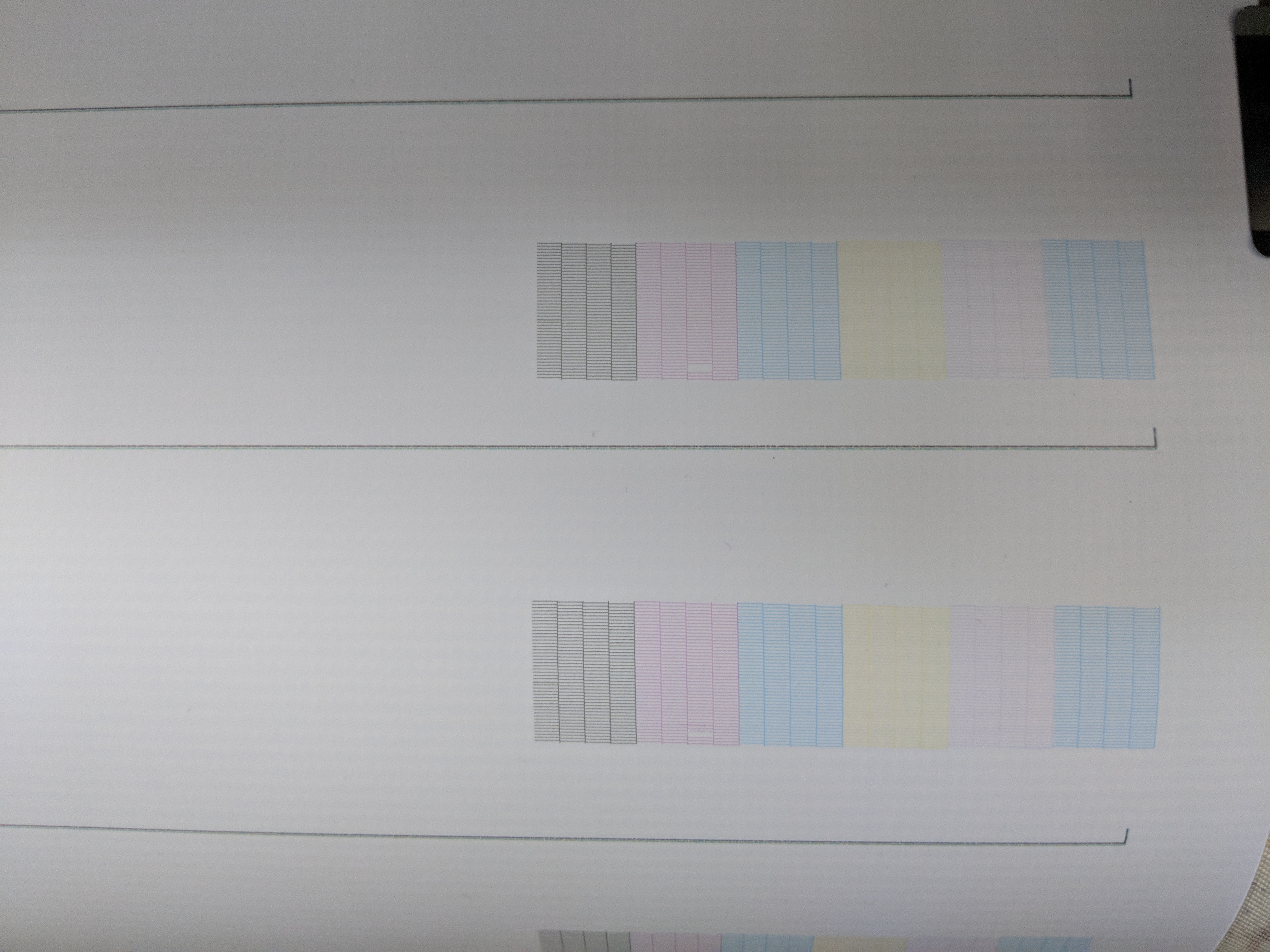

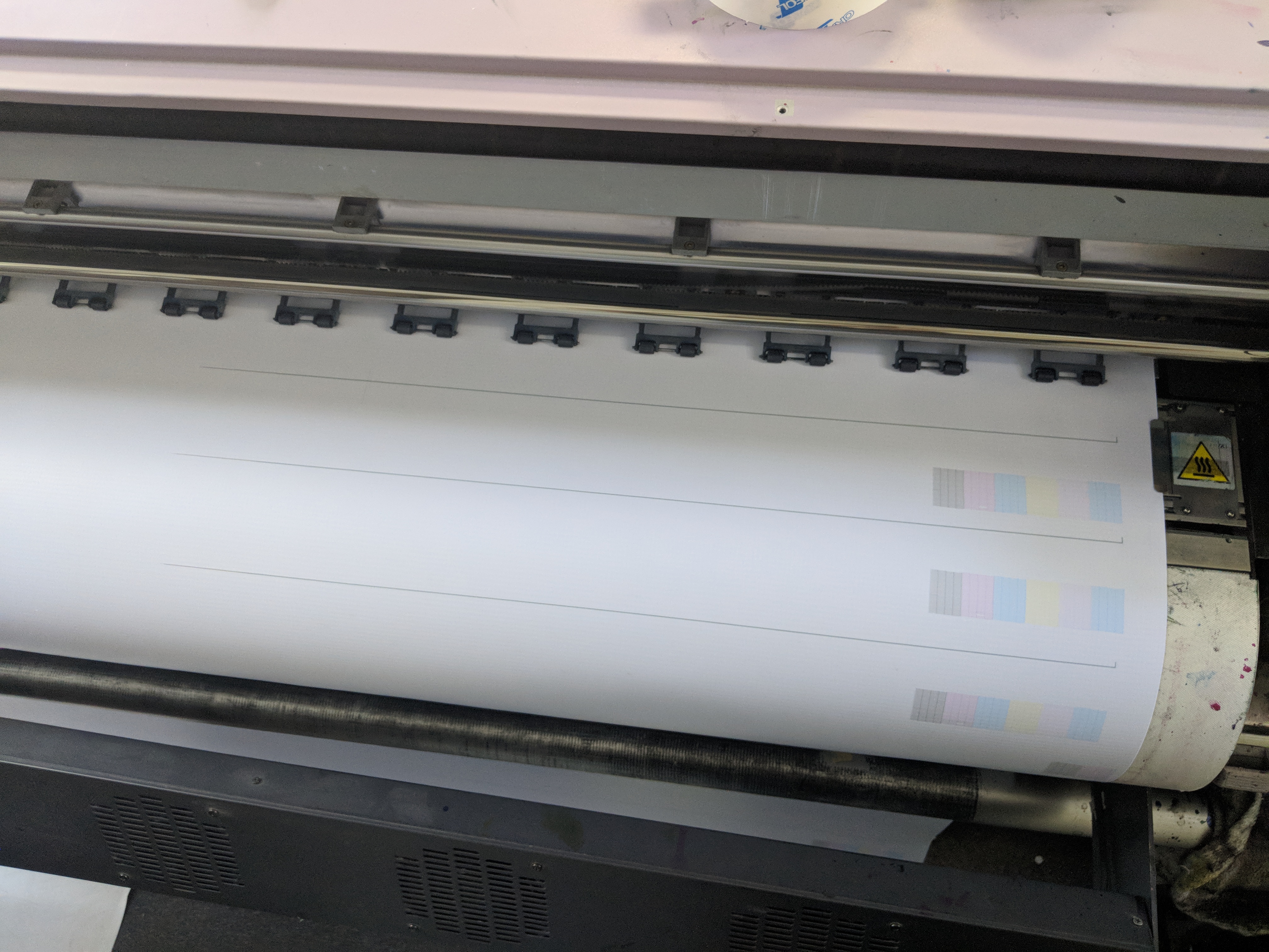

Im been trying juat with this one connected but still i dont get any print. Has anyone else had this issue.
I just revived thsi machine .It reads the media well but by the time to print it doesn't go all the way . Mybe the sensor or some settings idk. I have ss2 1x6 in the rip and in the printer settings.

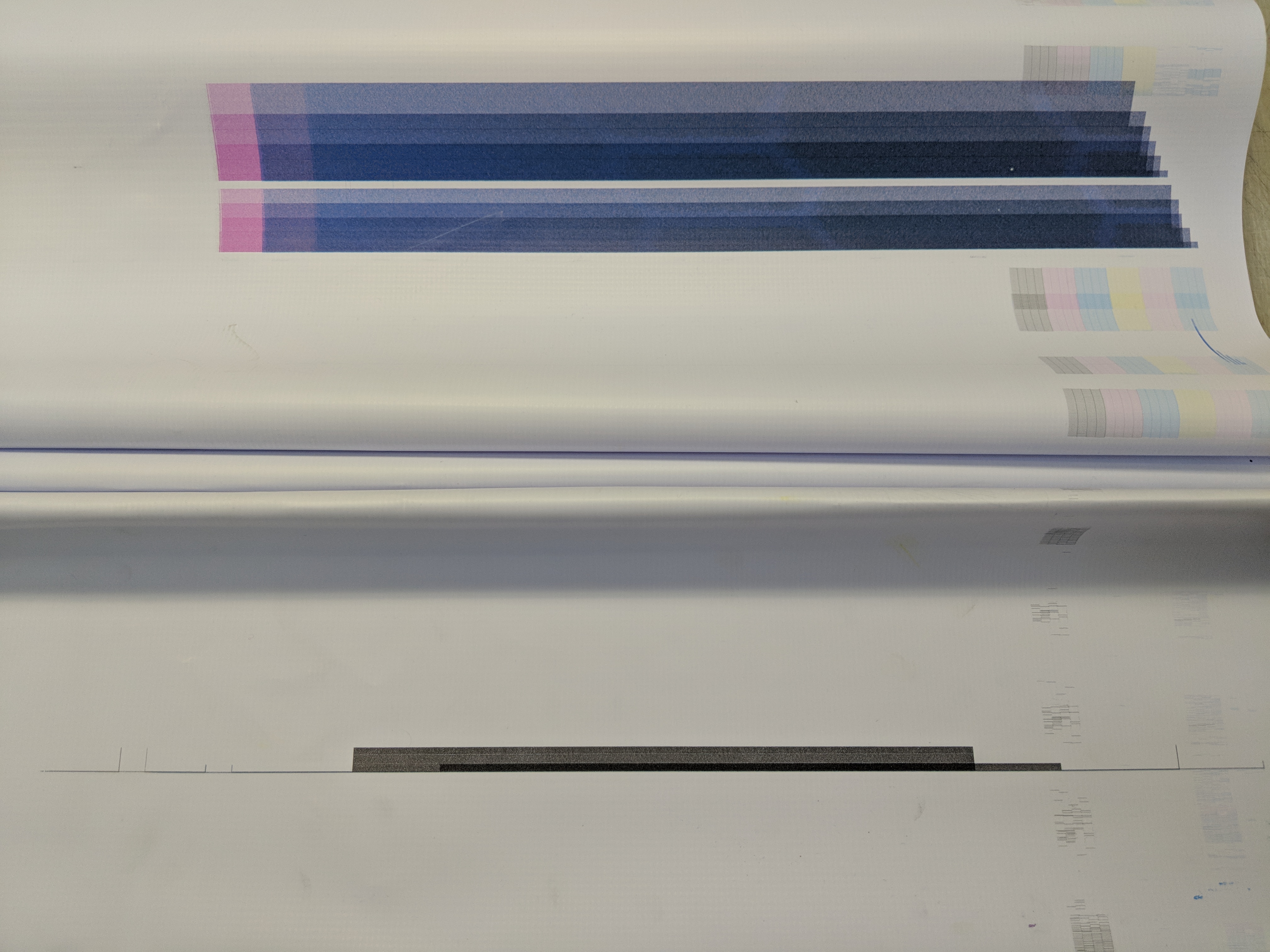

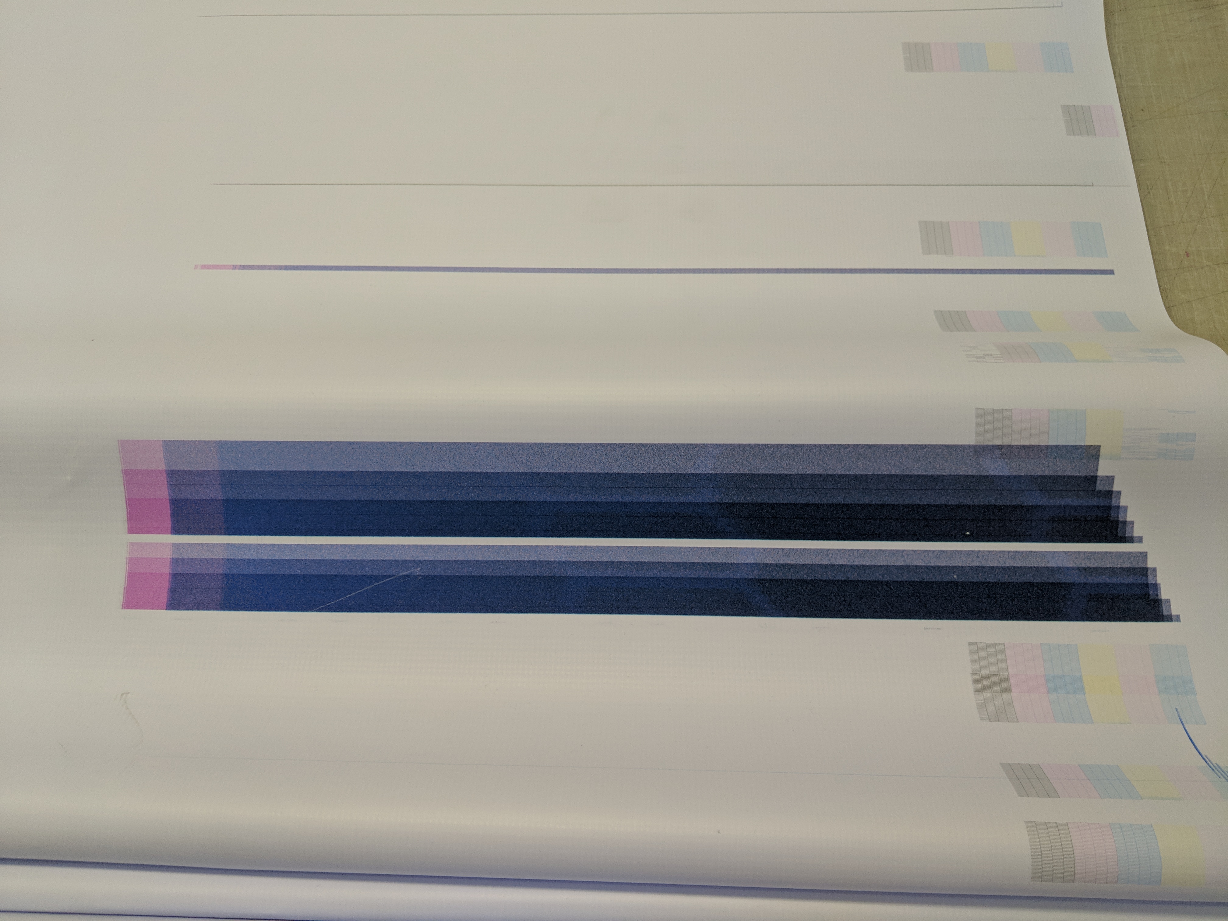

if those were the test prints,they are fine.
the bars are calibration test for media comp.they also look fine for now ..
unknown what the fine lines across are

I know the print test are okay but the other are suppose to be a image. A banner i was traying to make. It print till the half size of what is suppose to be be. Do u know how to calibrate it
