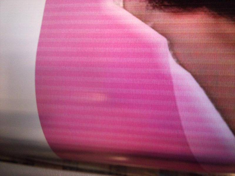

My name is Mario. I use MIMAKI jv3 160 SP. I have a problem whith stripping pasy.jpg Have You any ideas? Test print looks good. Rip: Posterprint, ink: Triangle. Thanks for any anwers.

design a test print of a large block of single colors (c m y and k). if it's ink starvation, you have to isolate which channel. also, please move this to a fresh thread.

Thanx a lot for answer. I will try on monday.
