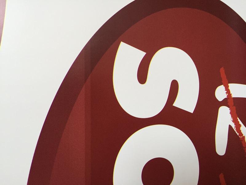

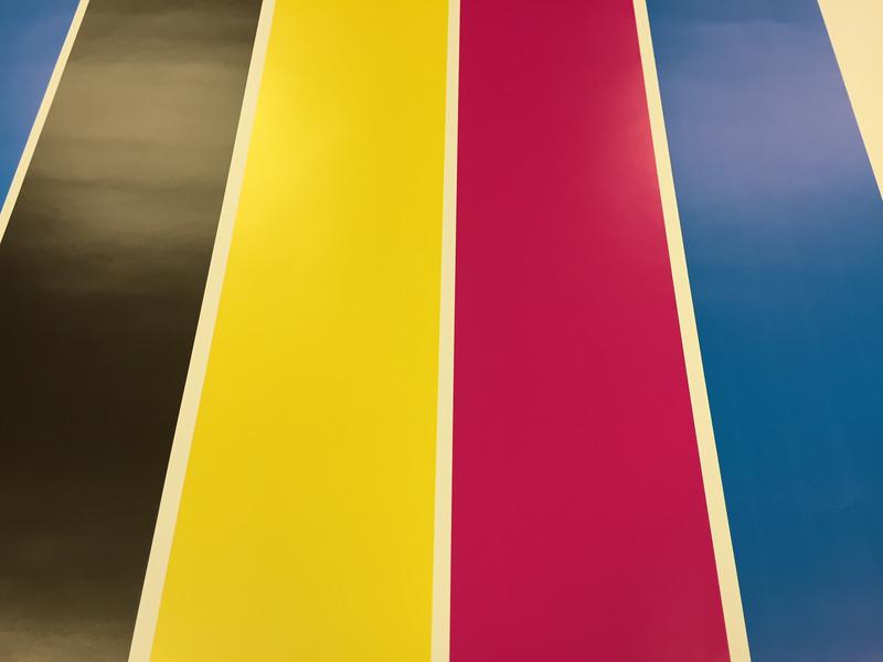

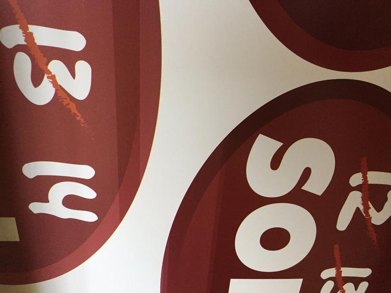

Other times, it is printing, then half way through the print it acts like it's only printing at half color. Or a certain color ISN'T printing so there's a very noticeable color shift in the print and that specific print is ruined.
It goes from full color to a dulled out, grainy, half-color print. (I will attach a photo I took from a print job today)

MikePro
might be a pump/capping station issue, not properly refreshing the siphon-effect of your ink supply, and causing "ink-dropout" issues when the demand for ink exceeds the supply.
else, you could be running on an empty ink cartridge that the machine thinks is still full. as the machine senses the volume left in the bag in the cartridge, mechanically, via a trigger that could not be functioning properly.

You're gonna have to look under a loope and see what color is dropping out. And then go from there checking/replacing.
most definitely looks like the black, as I don't see any hint of the rich-black CMY values in your disappearing print.
a good start to check if the pumps are working properly, is to run a buncha diswaywash cycles. if the capping station allows you to fill the caps with cleaning solution, pump them empty, and repeat... then you should be good.
if it were me, I would then confirm this by opening up the back of the printer to expose the ink pumps and running some fillupink cycles on the black channel.... observing whether the black ink is drawing thru the pumps properly.
this could also expose a capping station issue: during this operation, you may notice the black ink coming down through the pump/waste line a bit staggered/bubbly, compared to normal solid-streams of ink during normal function, as the captop is not making a proper seal with the printhead & drawing air in through gaps in the contact with the cap/printhead. if so, this can be attempted to fix-easily by slightly tugging up on the black rubber captop (not removing it, but slightly dislodging it from it's current position), and once the printhead carriage parks back on top, it should snug itself fit. (making note that capping station/printheads should be pristine, or at least free of chunky ink-buildup.)

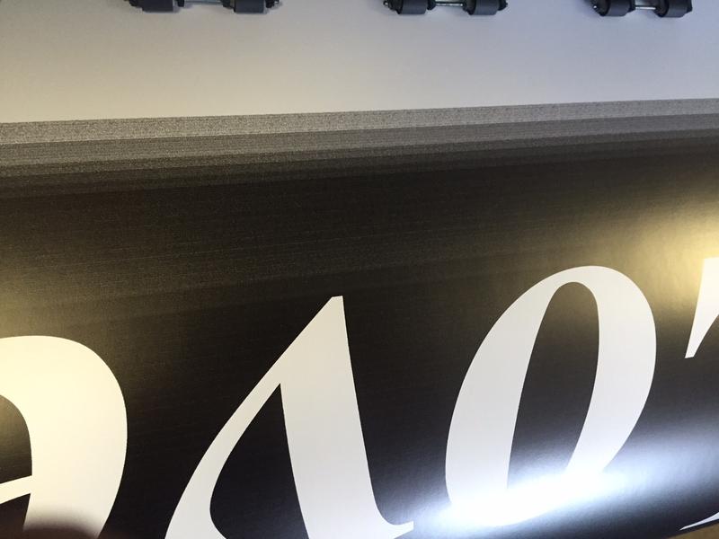

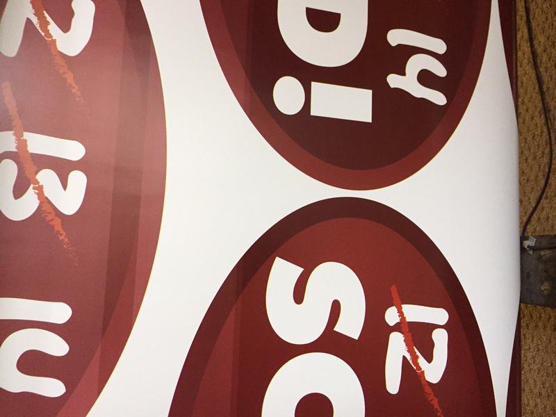

Today's first problem.

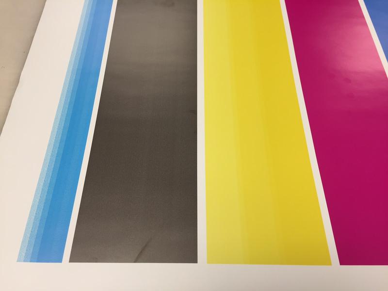

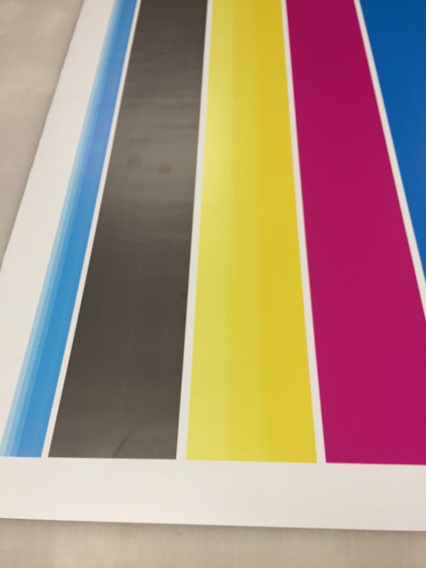

So I thought it'd be a good idea to print strips of 100% of each color (CMYK) - attached photos of the results.
Wanted to see if it was 1 color in particular..
The first pass, everything printed just fine. 100%
Second pass through the yellow started going, then the black and cyan.
I was hoping to pinpoint 1 individual pump if that was the case.. Looks like I can't do that since the yellow started acting up too. I believe the Magenta would've been next if I had let the print continue.
Does this look like it may be the capping station and dampers?
