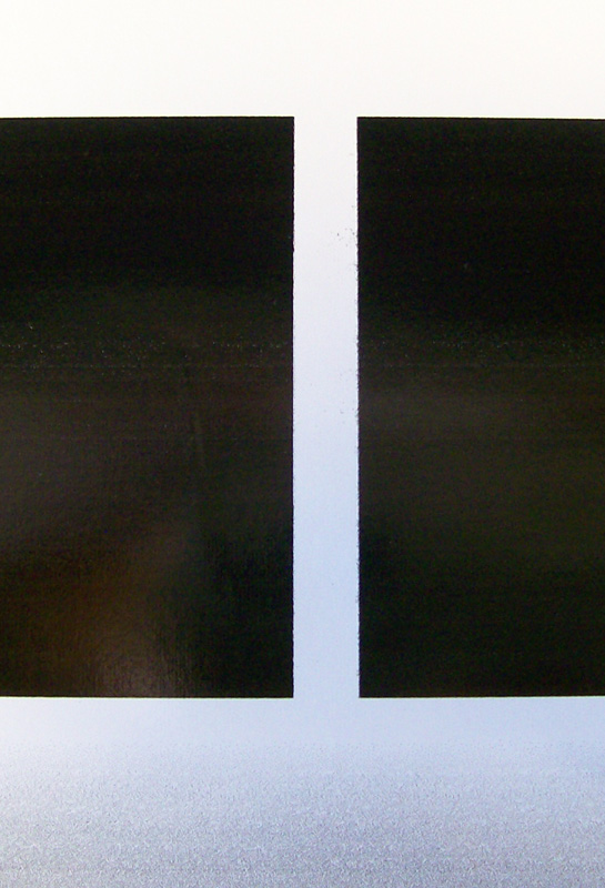

I have a JV3 that doesn't like to print black. Here is a sample image that shows what is happening. I am just printing this image with the black cartridges. I have been having this problem for a while but have been able to side step it. But now I have some time to put some more thought into it.
Is this ink starvation?
and if so, What is the next step?
I have also replaced dampers a couple times and the problem persists. Oh I have also attached what it should look like.

that looks like a data issue. ink starvation would print fine then fade a bit then drop out. maybe you should also upload a pic of what this file was supposed to look like. ...was it a black square? although there are lots of diagnostics that can isolate and possibly cure this issue. 90% of the time, a new head is the only fix.

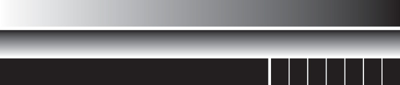

well, it looks like you aren't getting your variable data dot size to print from that head. for test purposes only, do a gradient (grayscale image) rectangle about 2x30. set your rip to print from the black only (rasterlink would be color edit/color matching/gray balance. this will isolate your black head. other rips are different of course).
see if the head prints different between non-variable data rips and variable data rips.

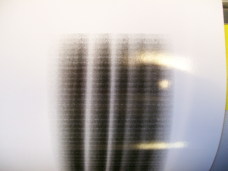

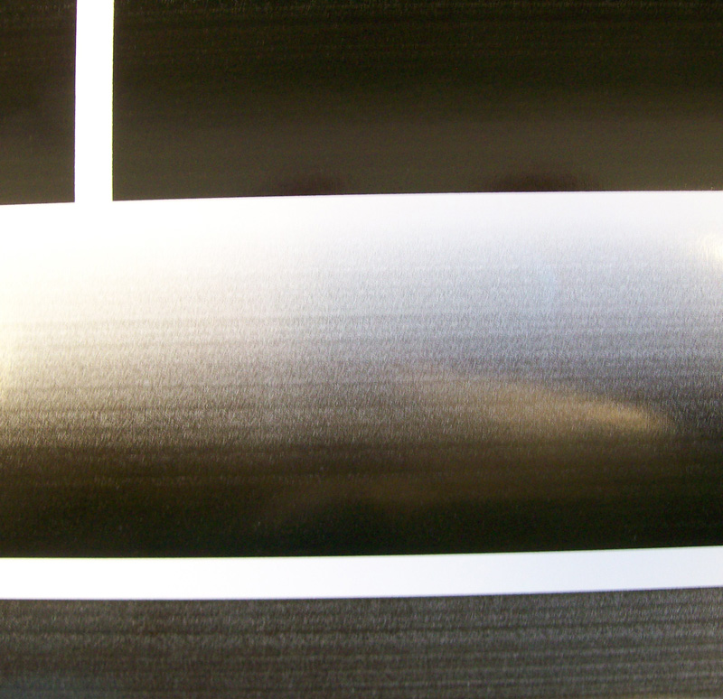

Here are the prints. I am not sure what non-variable/variable rips are. Do you mean that I should print them without profiles affecting them? The print I did was with no profiles enabled.
Thank you for your help so far! :)
There was a little overspray. On past print rich in black there has been more.
Sometimes it seems when printing a solid black bar the first 2/3 row come out perfect...

artbot
variable dot is when the head creates different sized dots to dither lighter smaller shades. in rasterlink a rip resolution will be shown at say... 720x720VD or 720x720ND.
it does look like you aren't getting the super small very fine dot patterns. but then it also isn't freaking out at small dot patterns with over spray which is common when a head loses it's very fine dot capability. there is a chance that all these tests were run in ND (non-variable) mode.
are all your other colors equally grainy? also, does the issue get better when running uni. lastly (usually first), do a damper swap. put the magenta damper/line on the black head manifold. do the same test running magenta to that head. you need to completely rule out some options. if the issue goes away, then you possibly have a bad batch of black ink or some kind of starvation. if the magenta prints grainy with some banding then you probably have a data issue at the head. this doesn't look like a vacuum problem. ...i'm assuming your test print is perfect?

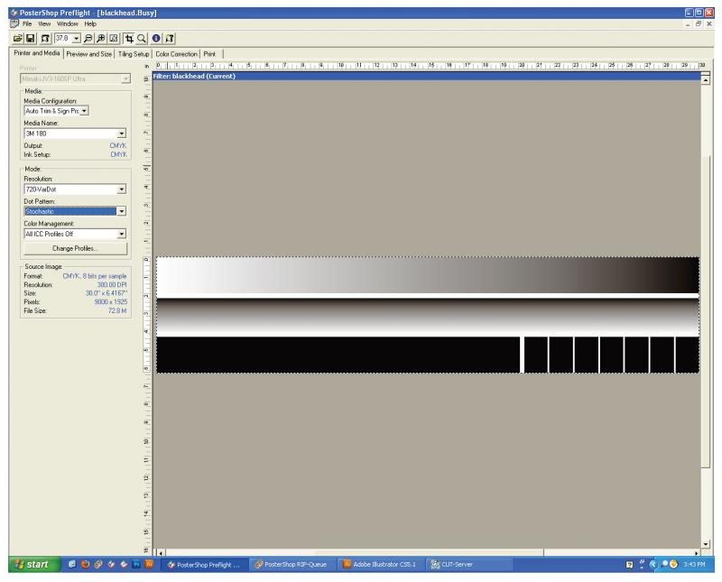

I am using postershop ver 6. The only print options I have are 720-VarDot 360x540-VarDot and 360x1080VarDot. (attached screen shot)

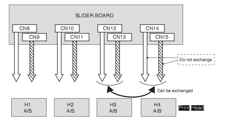

i think you need to do a data swap to rule out if it is a printer issue, other than that, without running a different damper/line to it you'll just have to hope it's not the ink and blame the head. that is ruling out the K priority rip issue.
attached two renderings of how to do a data swap.
turn off the power on front, switch off the back, unplug, press the front power button four times. after this your printer is dead. if you want to get really paranoid, work barefoot.
you want to see if th graininess moves to the magenta head. keep in mind that the y position of the colors will be offset because you've deceived the printer's data route. triple check that the ribbons are moved in pairs to other heads ports keeping top on top and bottom on bottom. do not cross ribbons at the one head.

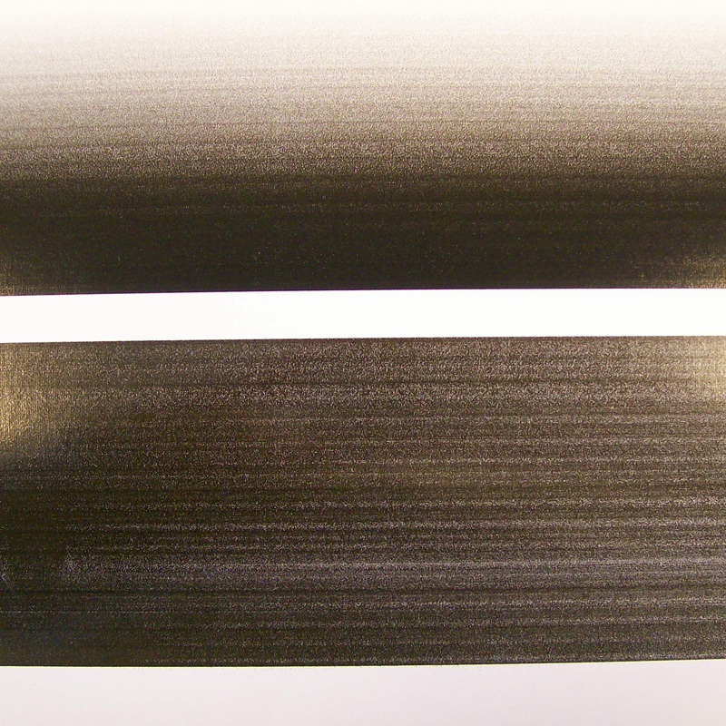

I made the switch from magenta to black and black to magenta... The magenta acting as black printed perfectly! So that means that it isn't the slider board and it isn't the data ribbon, right? So we are to the ink and the head right? would you suggest to flush the lines then use new cartridges or???

Doh! I had just swapped them back! :) K, I printed a magenta file through the black head. It turned out grainy as well. but not as bad as before???
artbot
so the black head printed a magenta file (using black ink) and the issue seemed to improve? or half improve? it's crucial that you get to the bottom of it the issue is disappearing with magenta data is sent to the black head or if the results are the same.
serverjohn
Hey sorry for the slow response. When I printed a file containing only magenta and through the black head(#2) it did print better but not perfect...
To make it more complicated, in general I do get varying results when printing just the black cartridge. Very rarely I will get something actually quite good. I am unable to reproduce that effect though.
So to clarify when I printed a file containing only magenta and through the black head(#2) it was better but did fall into the bad category.
Now I just printed the same thing again(#3) and it came out just as bad as bad as the first test print.
Now to when I print a file containing only black and through the magenta head the print comes out good. That would rule out the ink being bad correct?
