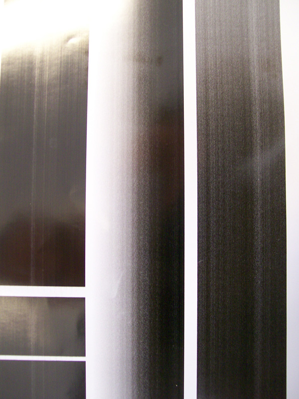

I am back with a little more testing done. Your right lists are great. To go along with it I will also show what I have done and the results.
Original
Black printing badly (As pictured in original post)
Magenta prints good
Swapped Magenta and Black data cables
File Color: Black -> Head: Magenta = Good
File Color: Magenta -> Head: Black = Better than Original but not great.
Black Lines/Dampers on Magenta head = good
So what I can tell:
Black Dampers = Good
Magenta Dampers = Good
Data Cables = Good
Magenta Ink = Good
Black Ink = Good
Slider Board = Good I think
Head = ?
Thanks Again!
artbot
if the black data looks grainy going to the magenta head, then no. if the black data going to the magenta head looks good and the black ink going to the magenta head looks good then you should order a new head.

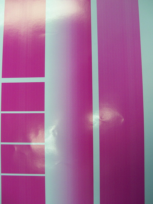

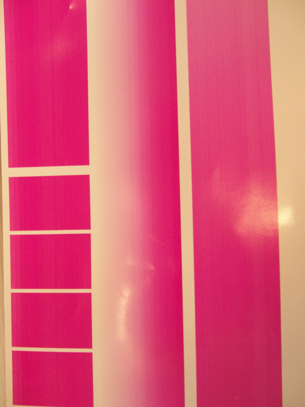

Here are some pictures of the data cable swap.
1) File: Magenta -> Head: Black
2) File: Black -> Head:Magenta
3) File: Black -> Head:Magenta, After adjusting media comp.
2 & 3 are better than the original but as you can see they aren't perfect.
Magenta normally prints perfect.
artbot
the one after the media comp look about as good as an isolated head file looks. heads benefit from added channels dot gain dithering and allow more even printing. much like if you were spraying a car and could follow the first spray gun with one right behind it. the finish would be better than one gun.
