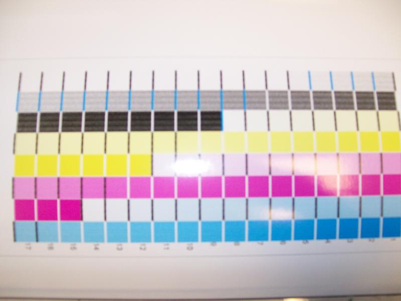

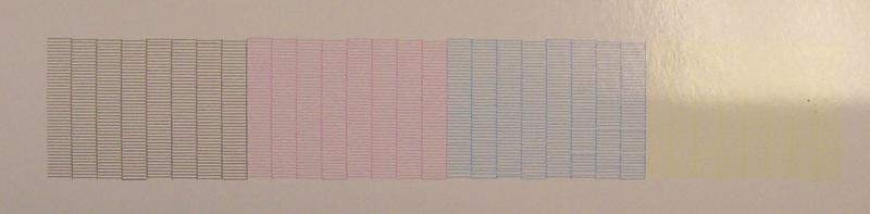

I need some help with figuring out what going on with my print. I have included 2 images. One showing a clean test print and one showing swatches printed very streaky. It is a small print so I don't think it is starving for ink but??? Have anyone seen something like this before?

In case anyone has a similar problem. I figured out from the help of some other threads that it was a damper(pretty easy fix w. dampers @ $22.50). I also learned the to much heat can do the same thing. I was printing banner material at 40 35 degrees and then lowered it to 30 27 and it helped.
Thanks for all the help! :U Rock:
