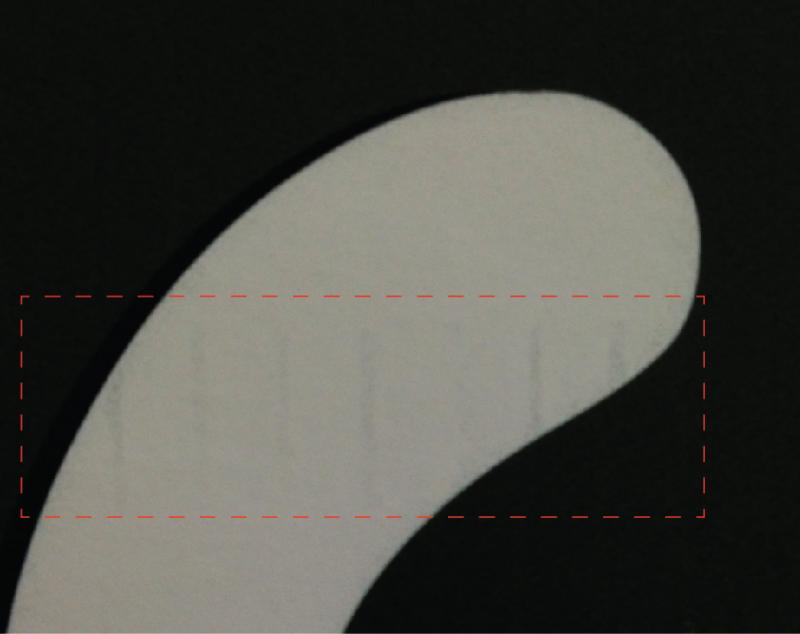

Hello everyone,
Newbie here. Been trying to solve this problem on my own with no luck. Hoping someone here could help me out.
Whenever I do prints with dark background, sometimes there are streaks on white areas right next to the background. This could be just outside of the print or on white text. I have attached a photo to show this.
It seems the streaks match the positions of the pinch rollers so I'm guessing they're the cause of this but I'm not sure what it is exactly.
I have tried lowering the temperature (which seem to help a little but does not completely solve the problem.), cleaning the pinch rollers but still get this in my prints.
Any help is appreciated (^^;)
Nate

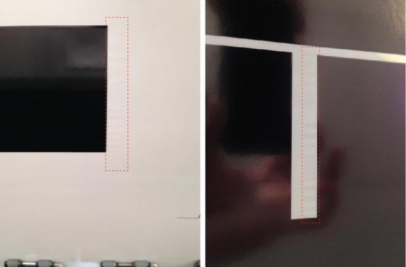

Test print seems to be fine. Very few clogged nozzles. The thing is the streaks match the pinch rollers in width and positions which is what I'm assuming is the cause. I'm out of ideas to be honest. :(
ff1to16
Okay I just noticed there are streaks even away from the dark areas... and they match the pinch roller width and position. If this helps.

Try printing one strip of black on unidirectional. If you have marks on both sides of the strip then it is definitely not overspray. If you print a dark blue would the marks still be black or would they be cyan? If you move the print over half an inch do the marks move as well or do they stay inline with the pinch rollers.
Looks like static overspray to me
I used to get this every Winter on my Rolands when the humidity went down. A tech explained to me that without proper anti-static measures, the vinyl and printer get a charge (let's call it +). Then when the ink sprays out, some of the + mist is repelled from the + vinyl and floats about for a while. Where the pinch rollers touched may have become slightly - (from friction or?), attracting the mist to settle there, causing "airbrush effects". Also general overspray issues, banding, color variances, splotchy prints, etc etc
Things I would look for would be: has the humidity dropped lately? I like to keep our print room 72 degrees and 45% humidity, which in Midwestern Winter means a 5 gallon whole house humidifier for a 12' x 20' room. 35% or less and we start to see trouble. Do you have ant-static measures like tinsel cord? Do you let your material acclimate to your print room for 24+ hours from storage or delivery truck so temperature and humidity can stabilize? If you open your printer cover and wipe a finger around is there a dusty coating of ink (from mist droplets floating around and depositing themselves on inner surfaces)?
There are other possibilities but this seems likely.

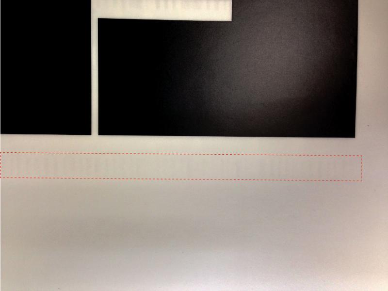

Okay, after installing anti-static, basically just an anti-static string on top of the media. I'm still getting marks on my prints :(

I have only done a few prints so far but I'm going to say it doesn't seem to help with the problem but it's still good to have anti-static. I'm pretty sure it has something to do with the rollers, just not sure how/why :(
Thanks for all your suggestions though.
