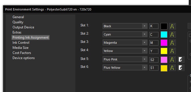

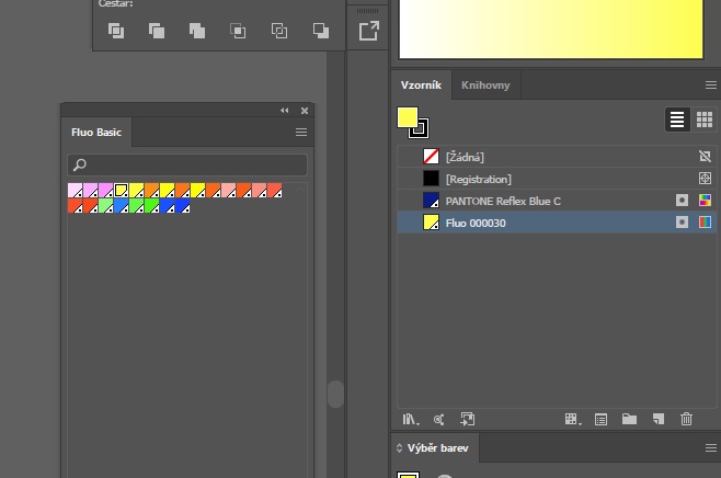

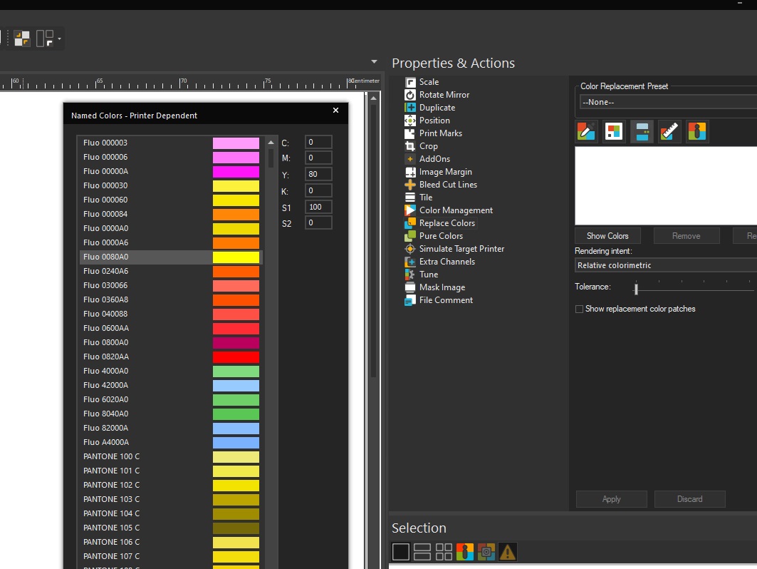

This is how I convert Mimaki to sublimation printers, where I add flou colors. The principle is the same for your JV33.
If you want to add red and orange, choose the C M Y K Lc Lm setting where you replace Lc and Lm. The printer will still run in normal mode.
However, then you have to take Ergosoft, which can control individual channels, Flexi can do it too.
In the graphics, you then use specific values Lba of color shades through which you control the amount of colors.
that’s nice! it’s what I tried with flexi and onyx, but no luck, printer wasn’t printing custom channels (changed chips, it should have worked). I’ve just changed to cmyk again, but will check ergosoft,

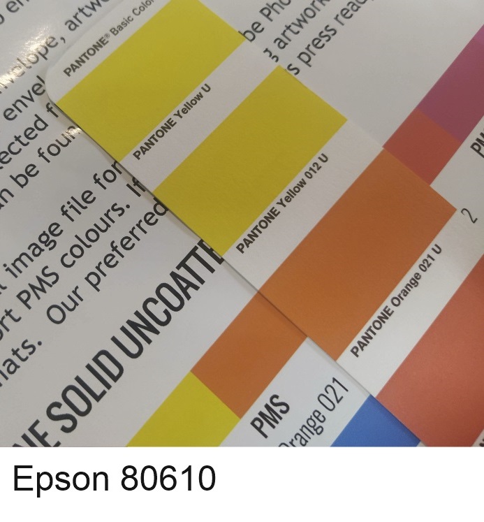

S80600 can do 98% Pantone .. Mimaki with Or, LM, LC, LK can do 94% .. but actually Mimaki orange ink is darker than Epson or Roland VG3 ink and doesn't reach the lightness I would expect. I have tried it, I make icc profiles, I was disappointed with the first Mimaki conversion to orange :(
