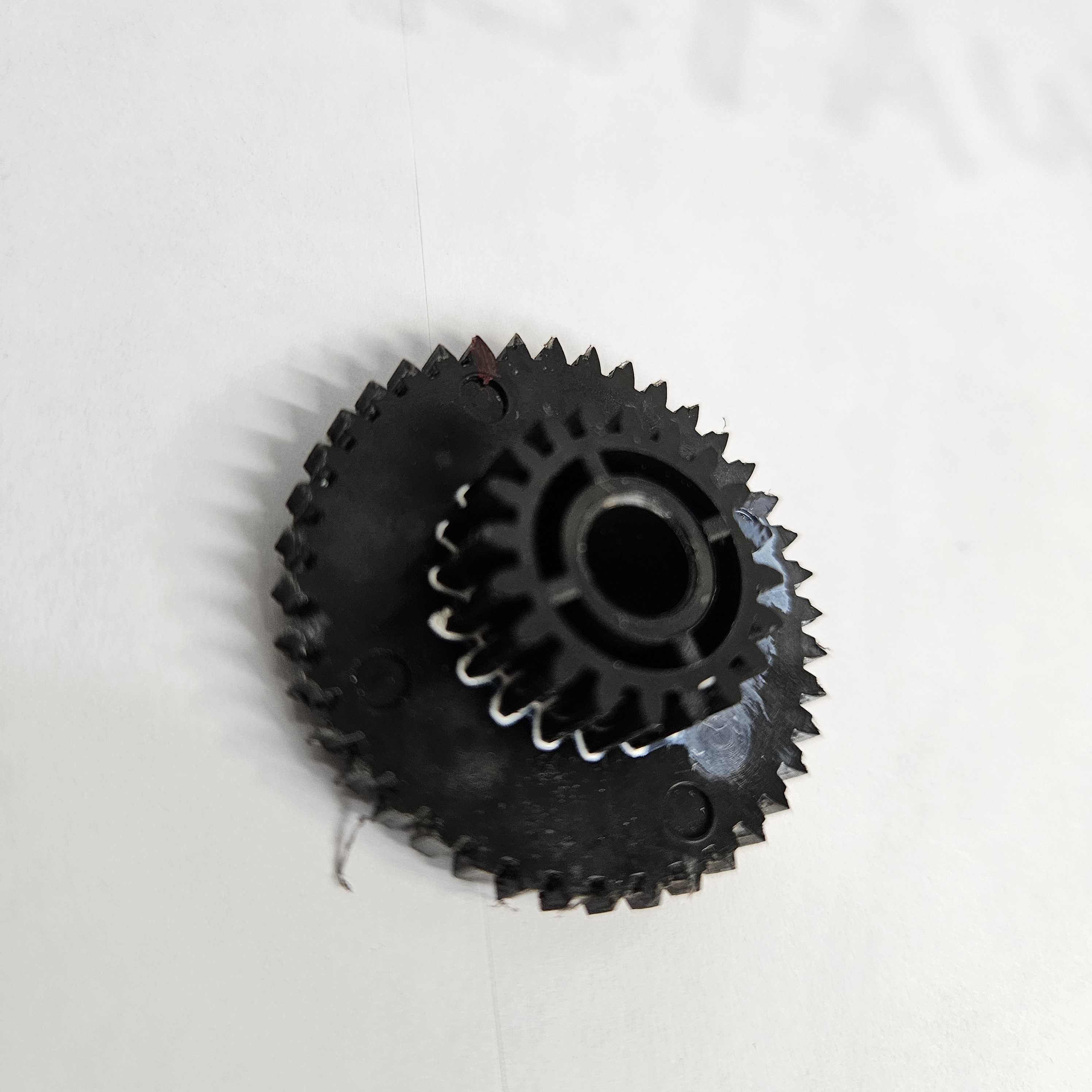

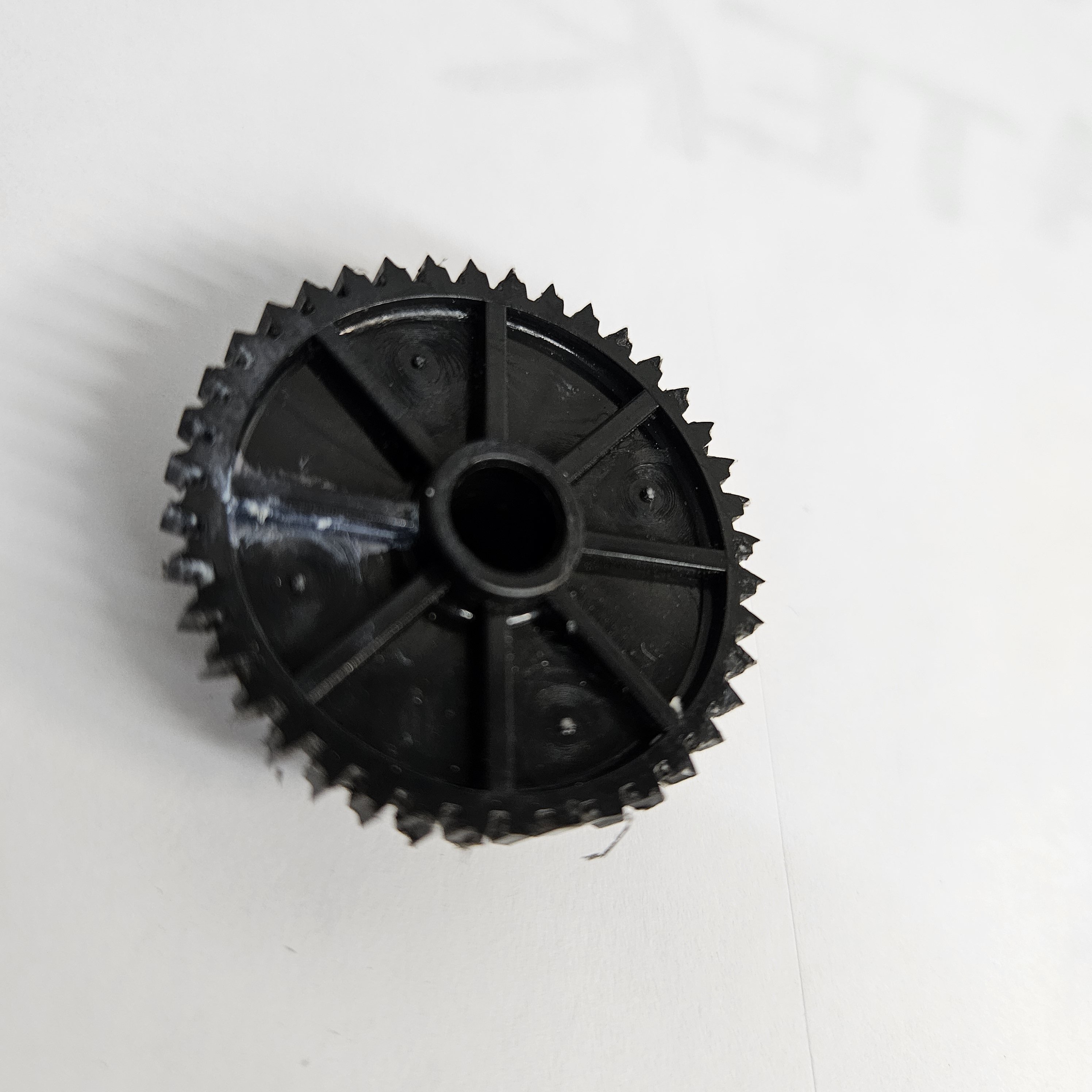

The large part of the gear has 40 teeth, and the small gear has 20 teeth.
Where would I search for this gear?

Dang, thought you were talking about the gear that is grub-screwed onto the motor shaft.
