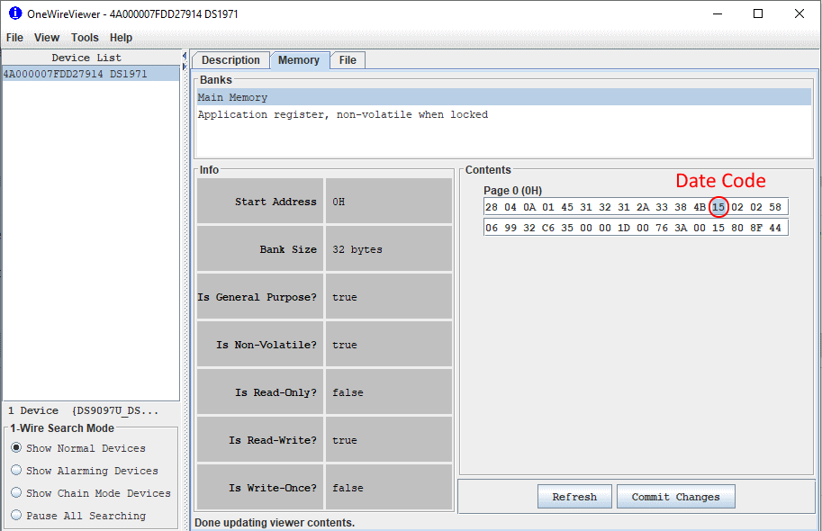

If you have access to a 1-wire interface, the 13th hex value can be incremented by 2 to buy you another year. If you don't, just ask and I can send you a programmed chip with a different date to use. Just ask that you swap me out an old chip in exchange. The chips are rewritable and can be used thousands of times technically.
Or, do the first redneck trick I used, set the printer time/date back a year. Works great on a UJF-6042 MK1.
Plan on posting a tutorial video soon on cracking and rewriting Mimaki chips soon. Only takes about $12 in parts.
I know this is an old post, but did you ever get a chance to make a video tutorial? What do I need to buy to connect the chip to my computer? I don't see much information out there and I don't want to buy a re-setter device. Thank you!
