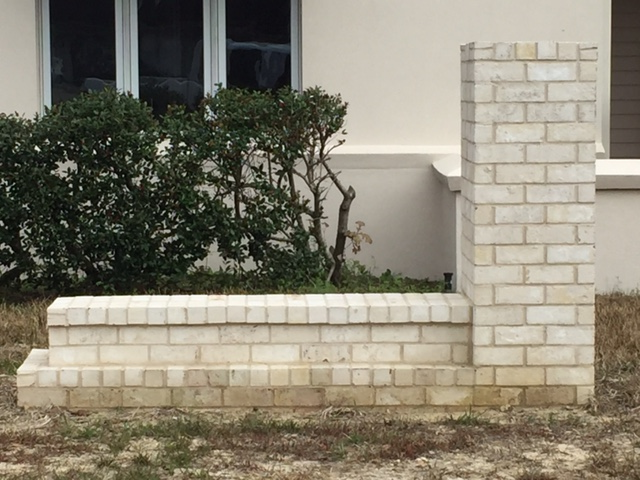

Maybe a silly question but I haven't done a 2 side install like this.
My plan is to use L brackets and use Cement anchor bolts and bolt the sign to the brick.
using probably 6mm Maxmetal or a Whitewood.
Let me know if there is a better way of mounting this sign.
Thanks guys.

you could actually NOT anchor to the brick work at all, being the back faces the building.
You can sink a couple posts in the back, and "STEP" the sign forward, so it looks like its sitting on the brick.
(for lack of a better explanation, or illustration to show you)
If I were only using the 2 sided brickwork, I would build a frame and anchor to the 2 sides. Your L brackets won't be enough.

Easiest, most economical like skyhigh said, or like dfleming, but unless done right and the masonry is really solid that could be pushed over.

I believe its going to be a little more than I bargained for but it looks like ill be welding
a frame to fasten it down.

The monument has to be well built and in good shape for a plate mount. But at least this one also has a vertical column to fasten too also.
I worked at another shop where did one on a brick base using the bolted plate method. The base was solid and the anchors seemed very sturdy.
A few weeks later the owner called, someone pushed the sign over! We dove right over, sure enough the sign was laying flat on it's face, still securely fastened to the brick base .
It was the brick base that hadn't been secured to the footing, just built on top of it with no connection.

In my opinion, the bricks at the bottom should not be used for attachment. That little double wall (no doubt made from hollow bricks) should be viewed as decorative. It will hold weight, but it will not hold up against sideways pressure, that is, back and forth pressure from front and back. Even without vandalism, and even with an attachment to the column on the right, wind movement will be enough to break bricks loose. Assuming the sign will be braced by a frame, the vertical left edge of the sign with its hardware into the brick will act as a pry bar. The lower left attachment will break loose first.
I am assuming any hardware to be used will penetrate the rowlock bricks at the top of the base and go as far as possible into the bricks underneath. Attachment to the rowlocks alone should not even be considered, in my opinion. Eight, ten and twelve-inch wedge anchors are available, but I am skeptical that they will tighten down solid at every penetration into hollow bricks. Even so, it may still be a weak installation and may not stay solid.
Having said all that, I have been proven wrong before.
Two posts behind the base is the easiest way to make this a solid installation, as skyhigh mentioned. An attachment to the column would not even be necessary. Next best thing would be adding a second column, or starting over, both of which would be expensive.
