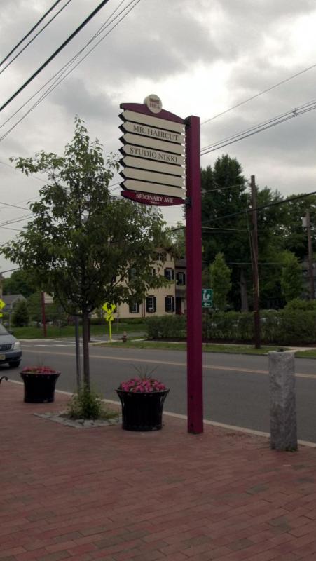

Just finished 12 of these way way finding signs in a historic district.

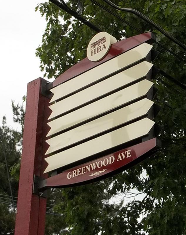

It's a 2" square welded alum frame with brake formed alum panels.
Pre painted channel letter material.
The over bent panels slide onto a track that is welded to the frame.
The logo on top is 3" hdu and hp vynyl.

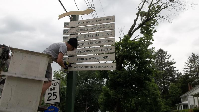

Here are some before and afters
