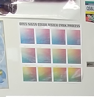

One thing id recomend it printing off the cmyk color chart from signlab (You can find it buried in the signlab program folder on your hard drive as a .cdl). Just import, size, and print. I put our name above and hung it up on the wall, so that I can reference it when I need to match a color. 20181204_134600~2.jpg

One thing id recomend it printing off the cmyk color chart from signlab (You can find it buried in the signlab program folder on your hard drive as a .cdl). Just import, size, and print. I put our name above and hung it up on the wall, so that I can reference it when I need to match a color. View attachment 141384
Ok, I found the .cdl file and imported it to Signlab. What next?
VPM doesn´t support.cdl so I have to convert the file to something else that is printable.
Are you sure that the colours won´t change when exporting to some other format?
Eps, pdf, jpeg or what?
