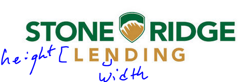

The one on the right is my favorite so far, my only comment is that due to the detail, it won't reproduce well in some mediums such as embroidery & cut vinyl.
Be careful here. Even extremely simple may not work in embroidery.
A typical logo crest (left breast area), we try to do at 3.5" wide.
If you size a logo at that size and if you are using simple sans serif block fonts and the height is less then .18", then it won't work well unless your embroiderer uses 60# thread and smaller needles. Most won't do that and I know a couple of users on this board that actually won't do letters smaller then .25" in height. .18" is actually as small as I'll go in height.
Also, stitch width is an issue, especially if you are trying to keep it as a satin stitch. If the width of the section of the letter is less then .03", it won't work as a satin stitch.
You would be surprised about what can or can't be reproduced, it just depends on what stitch types you are able to use within a design and size.
Size is the biggest issue more so then detail. Size dictates what you are able to do and if you are limited to stitch type as well, even really simple may not work. That's the irony, just because it's simple doesn't mean it will work. Lettering we try to do in satin stitch first and then fill stitch (if size and/or design dictate otherwise). Personally, I hate running stitches as lettering, but if you want lettering at a certain scale in a design, if you want it to still be there, that's what you might have to live with. Or it will be really crappy satin stitching.
I attached one of the OPs designs to show what I'm talking about. I didn't do any measuring, so don't think that I'm showing this one design as one that is a "no go", this is just to show what I was talking about especially with regard to stitch width of sections of an individual letter, as most don't think about that.

Good call Wild west. I honestly don't ever think of embroidery, even though I should. Thanks.
