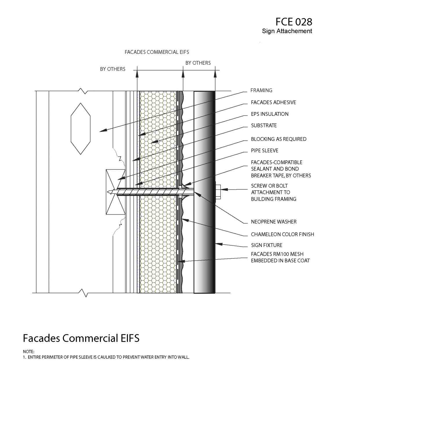

Oh, you're taking this too lightly. For someone like the OP, he needs all the help he can get. He needs pictures, exploded views and someone to spell it out for him.
Rick
Not an exploded view but a section view might do....
