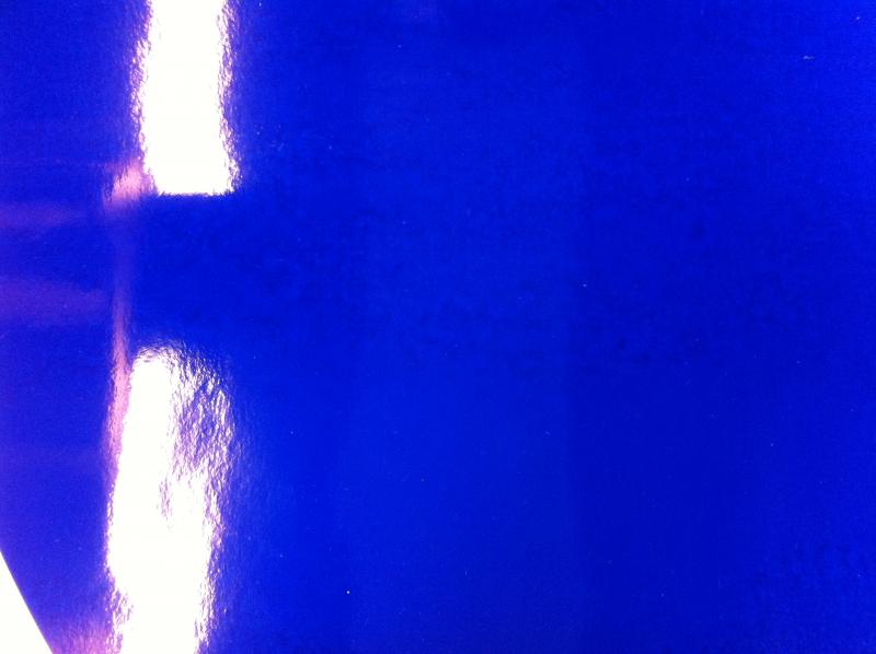

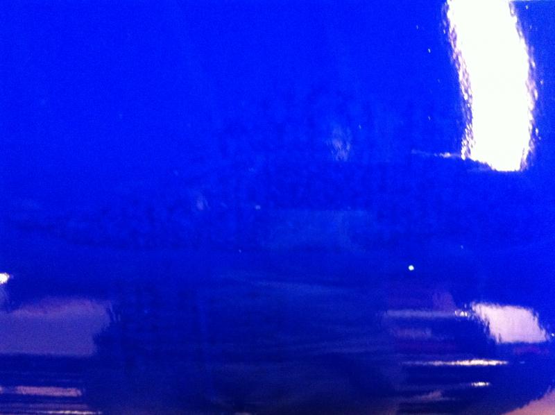

Trying to print a large solid and am having problems.
It appears to have very random area's of darker print that looks all orange peelish, like a bad rash, no particular pattern at all.
I'm not sure if it's the printer, the inks, the material, the color profile, or what.
Some advice/help needed.
Material: Avery 1005EZRS
Mutoh 48" ValueJet with OEM Inks
Color Profile is the Stock profile (Avery 1005EZ 720x720 Graphics2) that was preloaded with Flexi 8.6
Also, what do you guys do to prevent dust particles from getting into your large solid prints? I've kept my work area extremely clean but can't seam to print much without getting tiny fragments of dust or hair in the print. I've even gone as far as wiping the material with a lint free cloth while it's printing but still doesn't seam to work.
Thanks

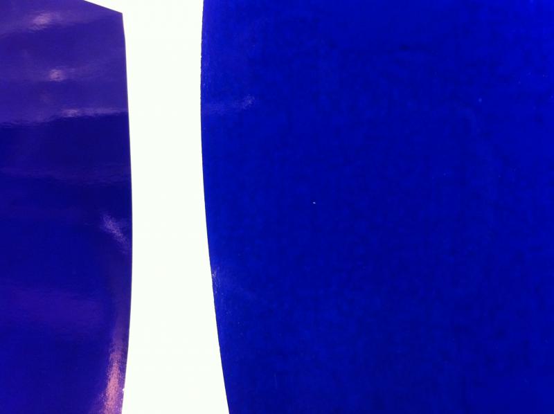

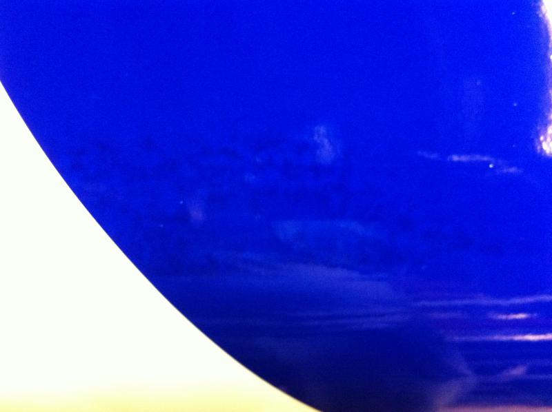

I thought maybe it was because of the color I picked. I checked the color and it was RGB color (duh). Switched it to CMYK thinking my troubles would be solved but all it did was make the print darker (which I knew it would), unfortunately I still get the modeling look. =( The color itself doesn't have to be an exact PMS color, just a good looking "dark blue" which was why I didn't bother switching it to CMYK in the first place.
Donny7833
Can't hurt to try, or maybe slow the speed down to give the ink a little more time to set. If your running Bi, try Uni.
Kemble
Hrmmm, the profile wont let me change from bi to uni, should I set it to uni on the printer then? That would over ride it right?
Kemble
Set the heaters to 50, 50, 50 and set the print to uni mode at the printer. It did run in uni mode however the modeling is still there ;( However the modeling is everywhere now, not just in random places, the modeling is in the entire print area now =(
