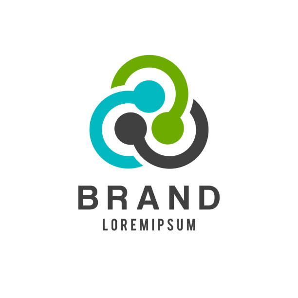

I've worked for a few different sign makers, and everyone seems to have a different approach to this. I'm curious how you all do it.
Here's the situation. We have a logo with 3 distinct colors. These colors are each to be cut out individually out of vinyl; let's say that printing is not an option. How would you personally approach the situation?
Do you cut them all out and assemble them together in the shop? Do you cut them, and mask them and then put them up one at a time on site? Wet or dry app? Is it different if the colors touch or overlap? What do you use for registration/alignment marks?
What is your process?

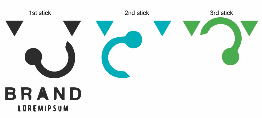

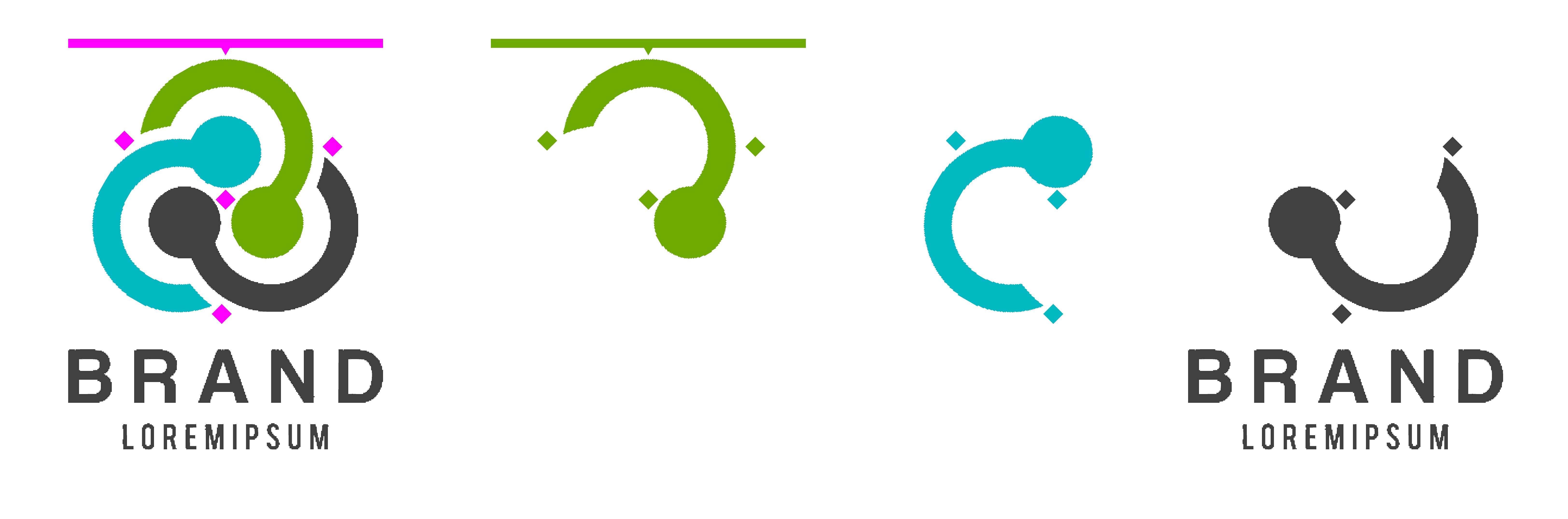

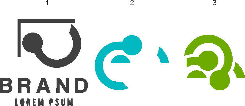

Usually I will throw in a level line and drop little registration squares strategically around the logo, then cut out the individual colors (one of them will get the level and center point marks), then weed and mask each individual.
When my installer gets on site, they can use the center line and level lines to get centered in the window or whatever, then lay the pieces one at a time. If I do my job right, and they do theirs right, then it all works.
We do dry application, but that's an installer decision.

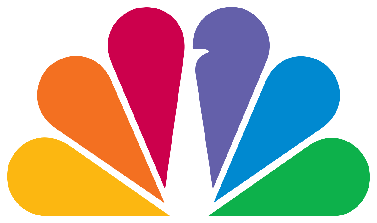

job can vary based on the colors and how they are laid out but generally i will install on site.
we do a lot of nbc vehicles and i made a template out of removable vinyl to lay the feathers of the peacock out correctly

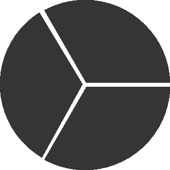

IDK man, 3 colors symmetrically spaced and all, item 1's placement is key, but irrelevant since the others are determined by it. Item 2, placed by hand, could be off a degree or two, which means that item 3 will be off by twice that compared to item 1, or half as much if the error is split between the two. This series of pie shapes has one out by 1 degree. Installer could have tried to check distance between outer points of the circle, but a 1/16" is hard to perceive through premask at times.
You copied the wrong part. For three colors, I said to make a template. Capisce ??
