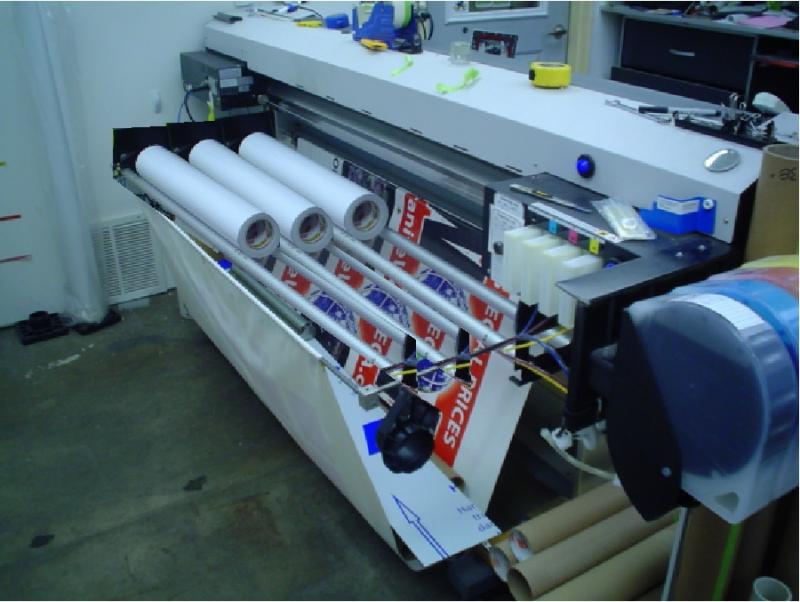

Maybe this pict will make more sense than my explanation. Using
54" rolls of course- just happened to have a 30 in the machine.

SightLine
Ah - at first I thought you were thinking on printing on 2 different rolls at once. That is also doable and most grand format machines are already setup to do just that. Only thing I do not like on that photo is the rolls are not supported on their cores. If one sits very long that way it will get pressure spots from sitting under it's own weight.
I've considered similar - trying to figure a way to attach rolls to the wall behind the machine but have not come up with much as you really need to be directly behind to feed the material in initially. Also on a Mimaki it has a rear pre-heater which needs the material to feed in from lower than the platen. It really can run fine without the pre-heater for the most part though.
MikeD
that's a great idea. I want the same thing for some of our printers, and have prototyped some things. The biggest issue aside from supporting the media on flanges, is keeping the rolls absolutely square to the platen. Having it feed through crooked kills the value.
As stated above, this set-up will most likely bypass the pre-heater. I have a couple IR heaters to compensate, but it's difficult to control how much heat is being applied.
Good luck! I know what it's like to heft around heavy media with a bad back...and I'm not that old!
