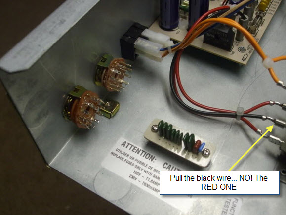

Hello...came in this morning to start printing and after start up my valuejet is giving me the "lever Up" error message, but the lever is down and holding tight to the paper...tried everything, took paper out, unplugged, turned on, turned off..etc... I am sure this is a bad sensor, but does anyone know how to override this message so I can start printing?

Remove the ink cartridges, remove the plastic covers, disconnect the capping station electrical wires... then find the power distribution panel. It is in the back next to the main board.
You need to remove the handle sensor wire. It is the black one.
