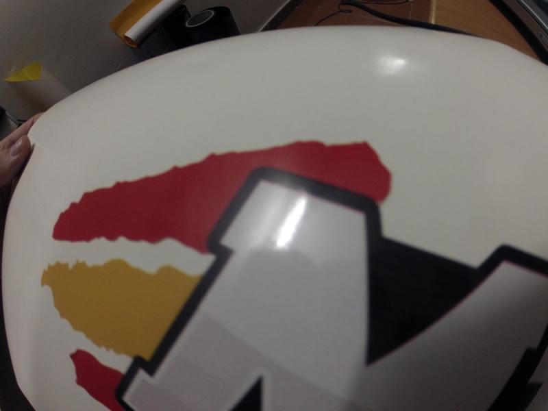

I'm new and I have bought a used Mutoh 1204. I'm using Flexising 8 and have the problem that the Magenta is offset. Here is an image and an example:
How I can solve this problem?

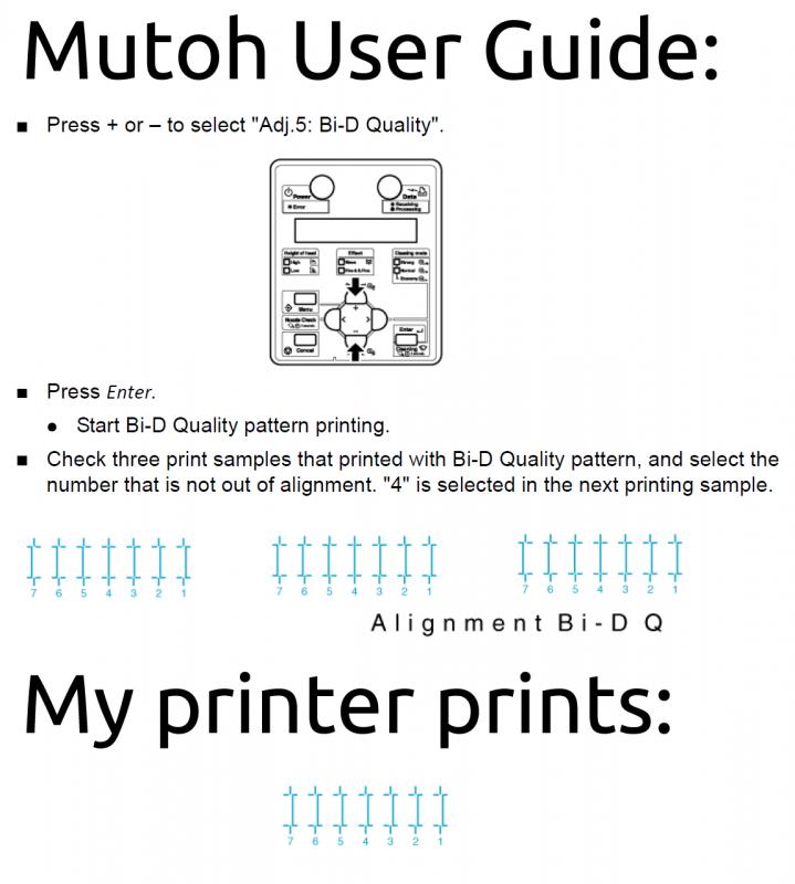

How I can align the head correctly? I tried the "Adjust Print" in the Mutoh menu (I read the User Guide) with no luck. I attach what printed.

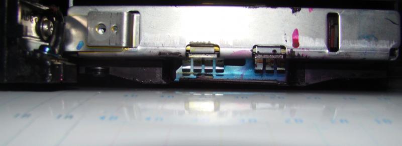

I attach a photograph I have taken to the head and It looks un-level. What do you think?
It make sense, in the last few month the pump doesn't suck well the ink.
The only way to solve this is using your method Compilla?

Followed Compilla post and my machine is fully working again. Thank you.
thewvsignguy
Ya might want to think about cleaning that printhead, looks a little dirty from the pics. Happy to hear your issue is solved though!
