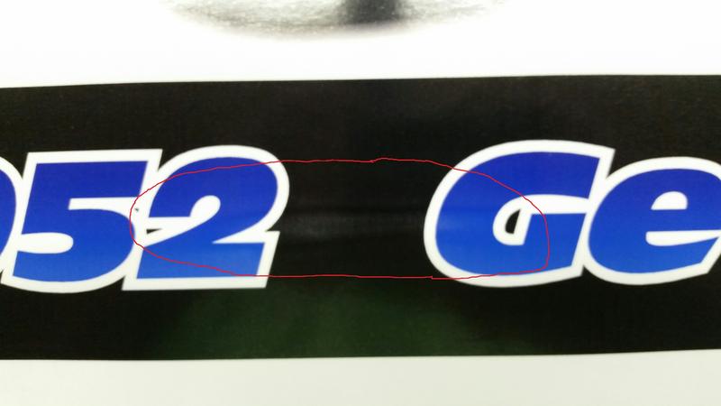

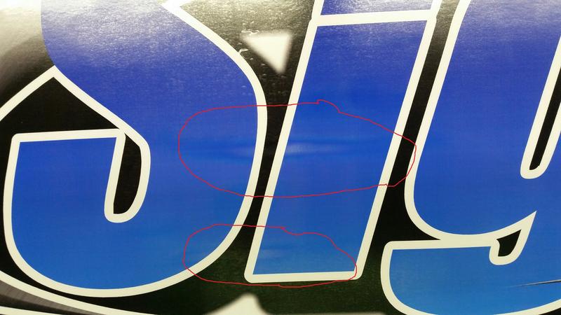

Today printing looked great at first but during a clean cycle it did the grind, after the grind I started to get odd streaky areas (see attached), I don't know if it's electrical, encoder or what but the printer need some TLC. We clean the printer at least 2 times a week, more if we do heavy printing.. We print between 2-5 hours per day of steady printing. The inside is very clean and I take very good care of this piece of equipment. I have only replaced the wiper (twice in it's life) and only use OEM MUTOH Ink, I also lube the rail every 6 months.

Without seeing your test print I can't say too much.
But I would be changing the complete maintenance station as this is a thing I replace yearly as they can get pretty well gummed up with ink.
The grinding noise is indeed the wiper assembly as this jams up and the gears that move it back and forth slip.
Personally I would leave the dampers alone unless they are leaking and not sealing on the head.
I have the original dampers in my 1604 and that is 8 years old and 3.5 years into its last head change.
Looking at your pictures that looks like either contamination on the material or a heating issue.

The test/nozzle test is perfect, no deflection at all.
