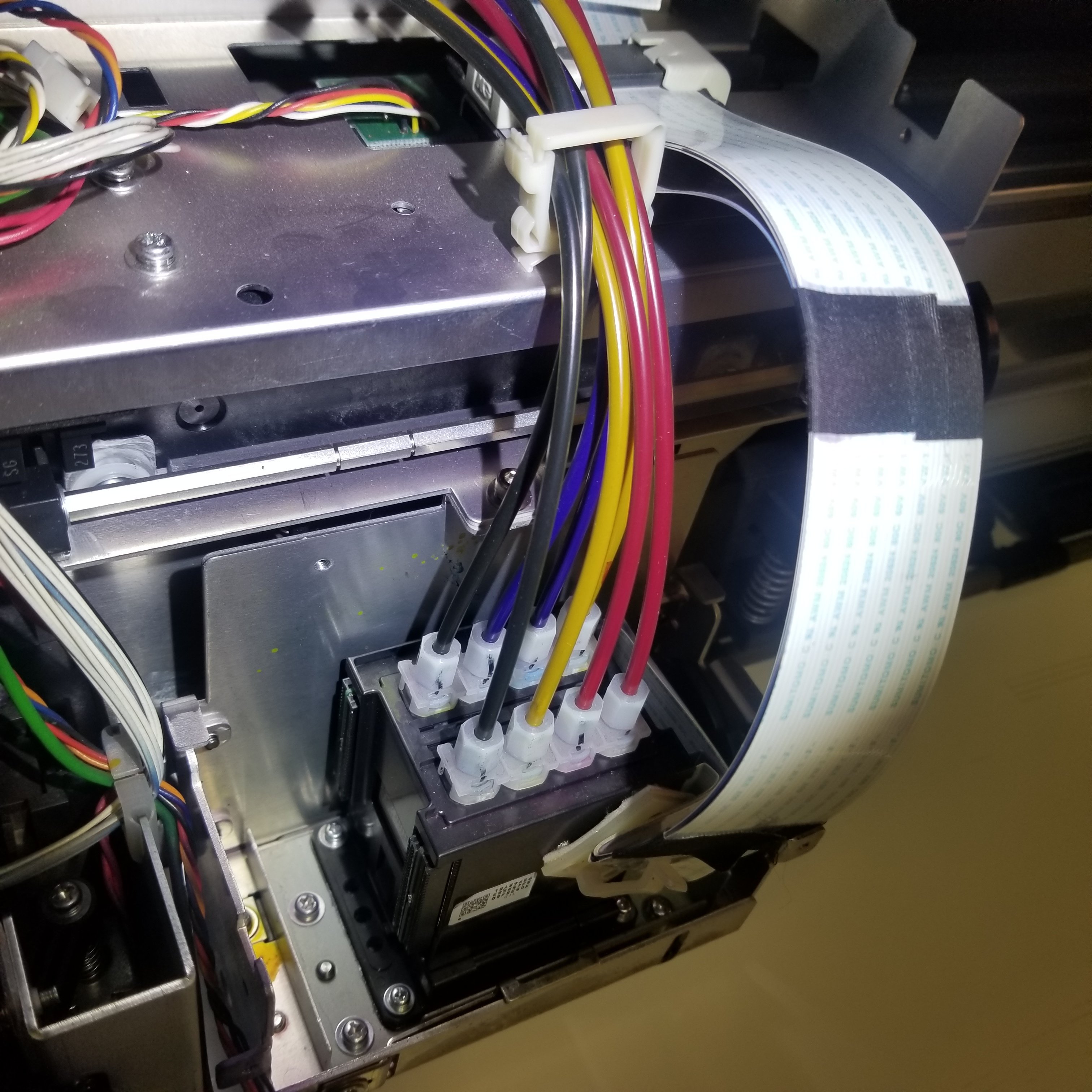

First thought I had was air leak where the dampers connect to the ink lines. Do you see an abundance of air in the lines? My second thought is the gasket between the manifold and the head

But back to the other issue, some heads develop a gasket leak between the manifold and the head proper. That would pull in air and probably leak ink as well.

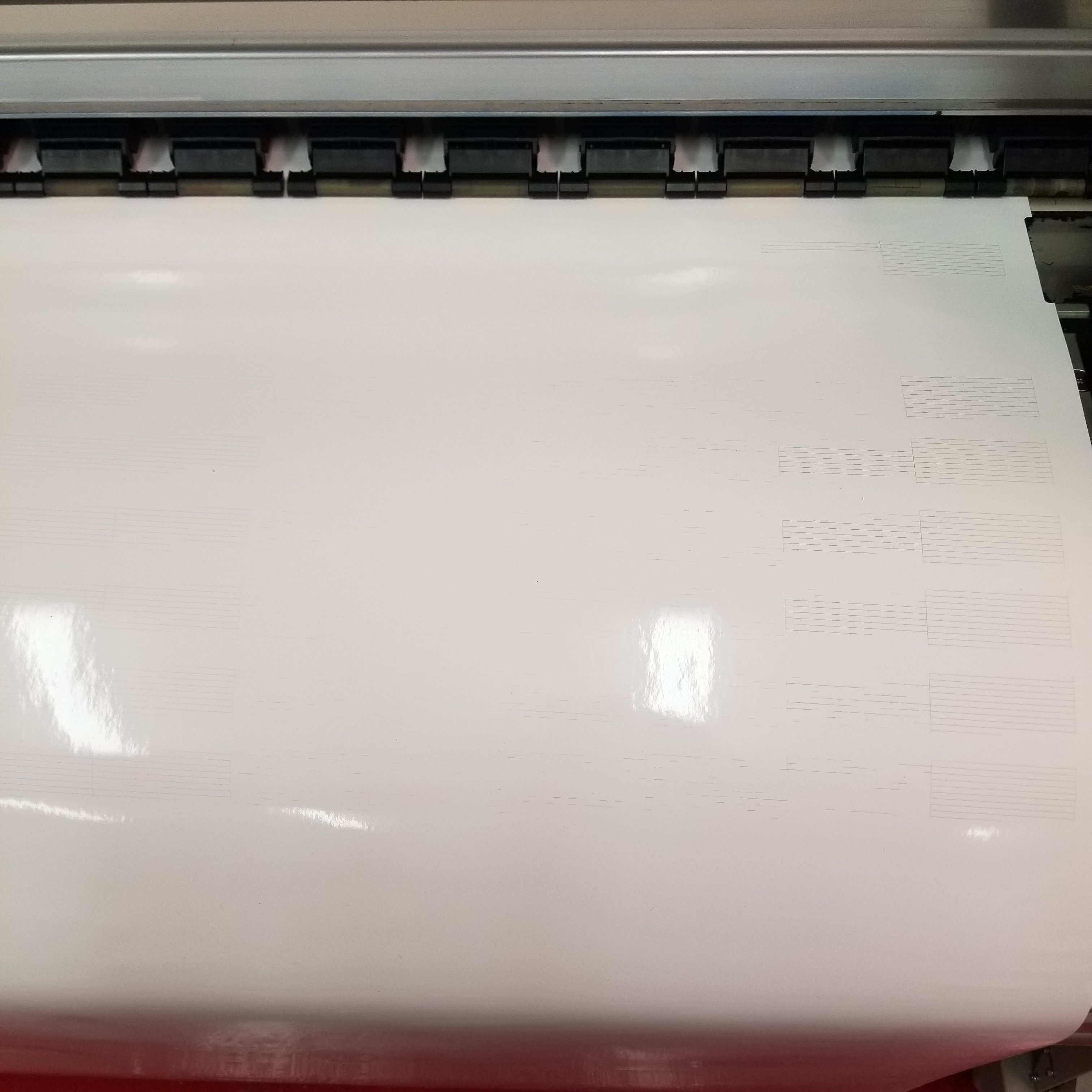

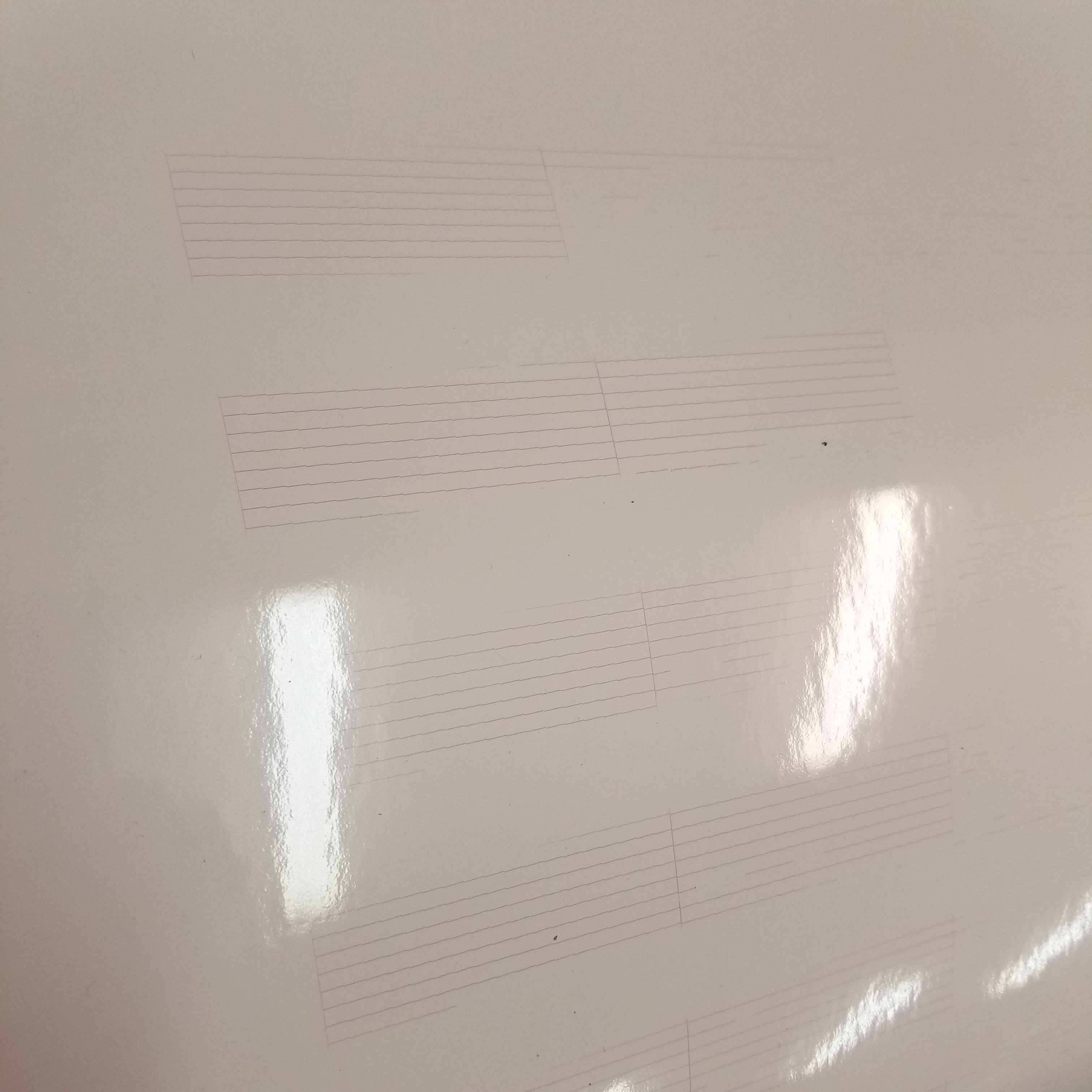

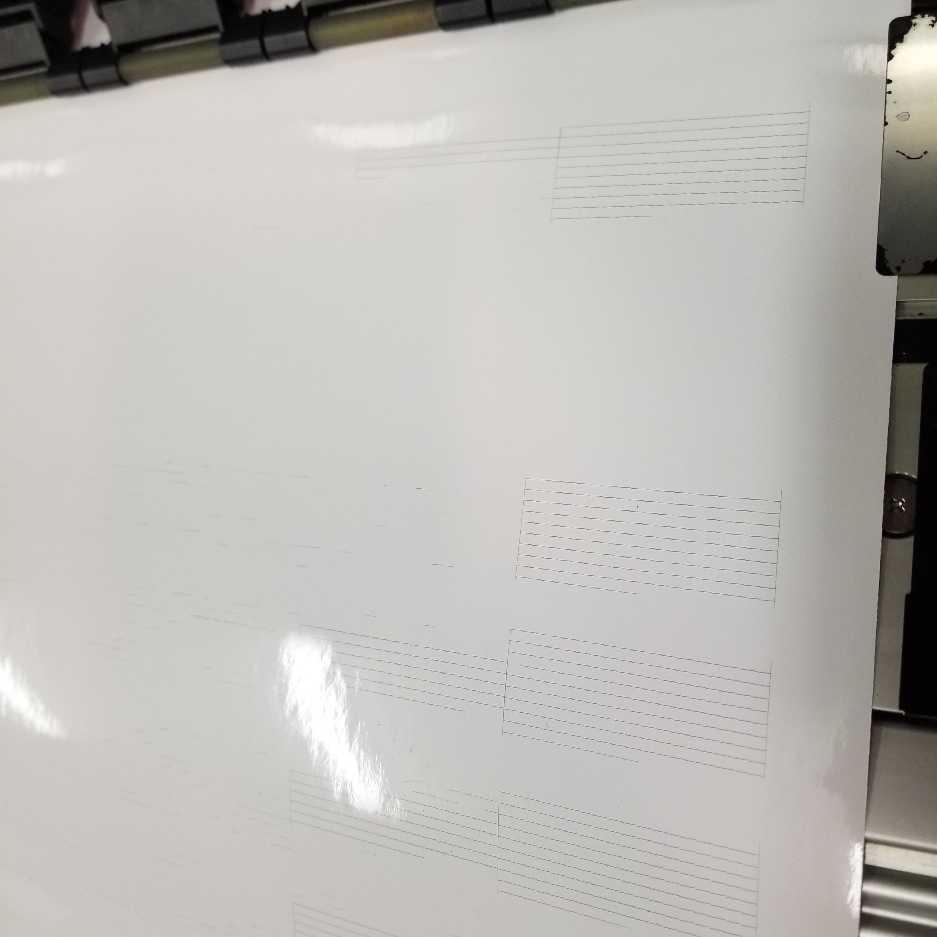

1624’s have twist lock connectors at the top of thr dampers, no need to cut off ink lines but there is an o-ring inside that connector. It does sound like you’ve got air in the head. When you do nozzle checks, do the missing nozzles move around? That’s a sure sign.

Here are my last few nozzle checks, I know they are hard to see, sorry about that. And a picture of the lines incase I'm missing something. The checks are sort of sparatic the second chanel of black and magenta kinda want to come and go.

Solventinkjet suggested running some cleaning cartridges through it on a longstore, and the tech on the fellers line said it sounds like the pump, but its brand new...
I'm wondering if I should maybe try to switch the dampers around and see if the missing blue or yellow will print in the place of the black or magenta. It least I would know it's not clogged in the line or valves. What do yall think?
