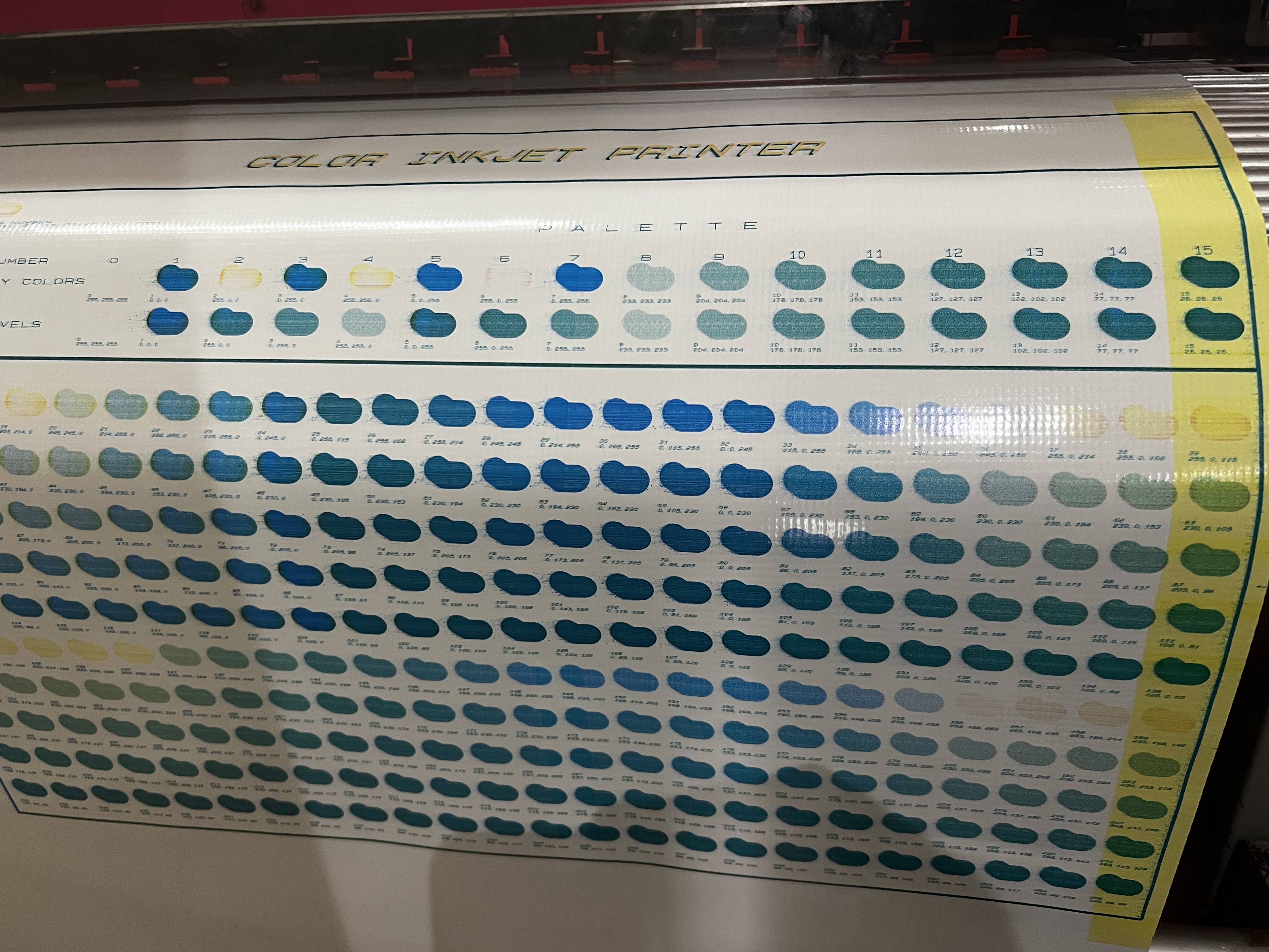

Hello, my Mutoh 1624x is not printing as should. I get no nozzle check (only a few cyan lines). I’ve done several cleans, used a syringe at maintenance station etc. I only get some sort of print when I try to print the pallet. See attached file

Seems like extremely dirty, properly clean capping station, wiper blade, printhead side plates without touching the head surface. Flush the capping station and make sure it flows perfectly. Run deep cleaning cycle, then most probably it will work perfectly.

That yellow printing on the right side indicates an electrical issue but I also agree with the guys above that the nozzles also seem to be badly clogged. The cyan seems to be deflecting pretty badly as well. You could try doing some head soaks, and/or manually flush the head with a syringe but that looks like it's going to need a new one unfortunately. Probably needs head cables and a maintenance station as well.
