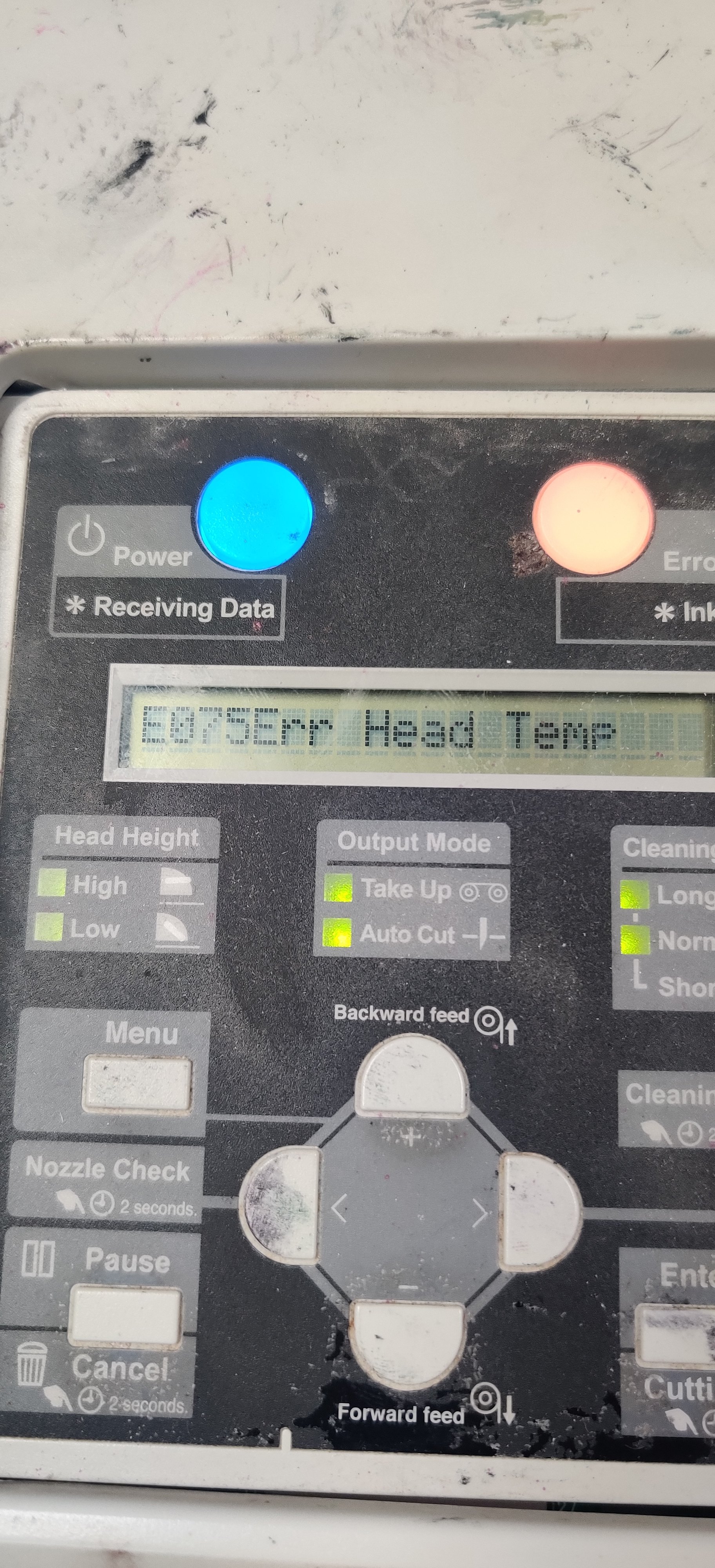

After replacing the 4 Head cables I received this error "E075Err Head Temp", cables were not OEM and after putting the Original cables back into the Machine error is gone but I am unable to print anything, nozzle check don't show and no ink is coming out of the head, everything else seems to be working fine.
Machine is a VJ1324, has anyone run into this issue?. I looked up the code and all i could find was "E075Err cable error" nothing about "head temp".

That error just means the head circuit shorted. Since it shorted, it most likely popped the head fuse on the main board. Did you compare the old head cables with the new ones? Maybe they don't have the right amount of pins?
Gus_3rd
you're right F3 fuse went bad, I'll replace it and hopefully that fixes the issue. Thank you.
