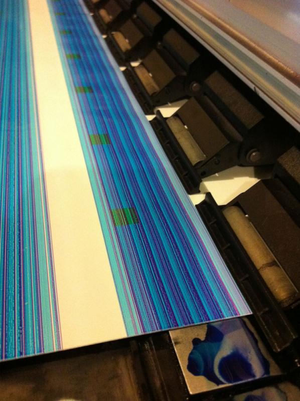

This printer has been printing like a dream all weak. My last print was last night. However, tonight, I get ready to do another print, and the nozzle check shows the whole left head missing. How can this be? I've tried several cleanings and I can't seem to get black, cyan and light magenta to come back! I've even tried sucking ink through the nozzles. That doesn't seem to help this time.
Any ideas?

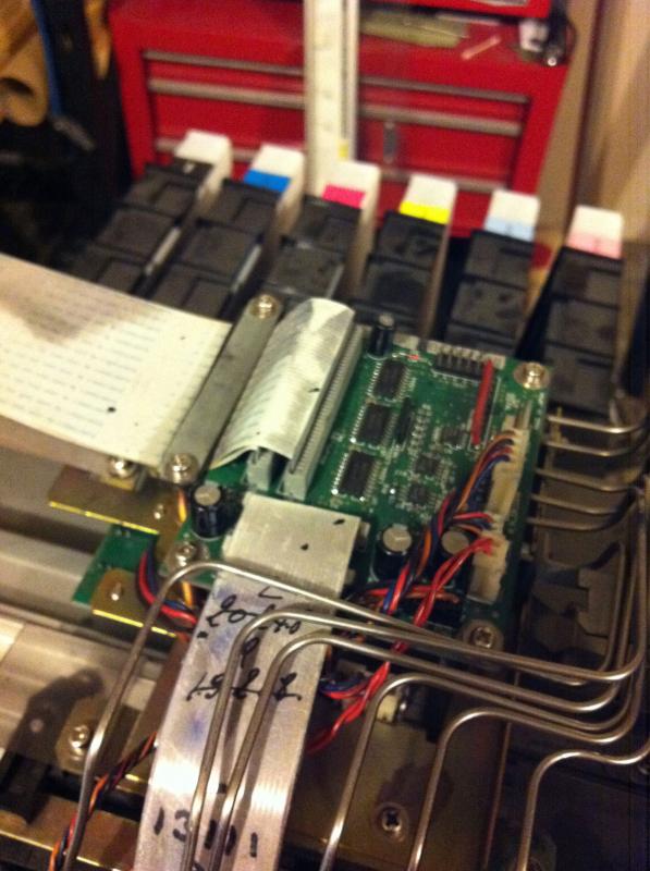

if the entire head is missing ENTIRE than its not the head. check your connection to the mainboard.
its not a head issue its an electronic issue.
just like a gas engine, gas and/or spark. your missing spark.

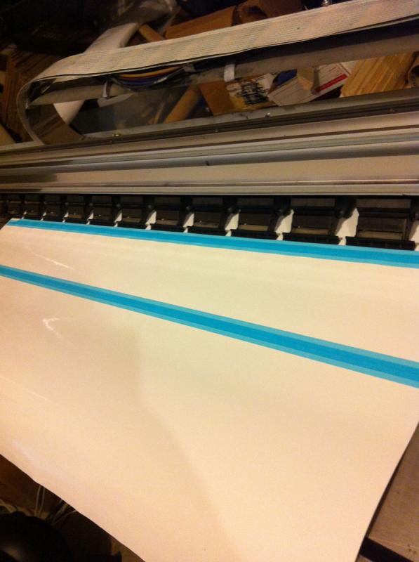

So, I reconnected or snugged everything on the board in the attached image. And now I'm getting a solid blue line for my nozzle check :)
Anything else I should check? Also, how do I make it stop printing a solid blue line as my nozzle check?

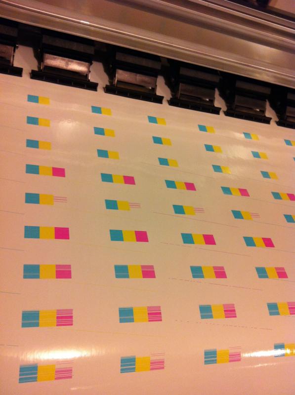

daenterpri
Here is the nozzle check from this morning. Just dumping ink, primarily LC, with a little bit of Magenta and squares of Yellow.
This is after I tried re-attaching the cables again.
Any ideas?

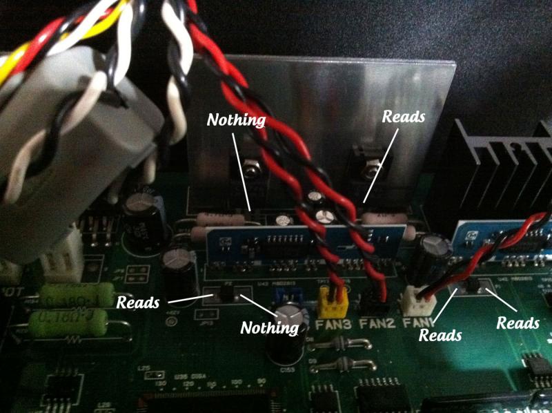

I found the main board. I even found the fuses. However, I know I must have blown something else up when I removed the cable while the machine was on last night, causing it to dump only LC during the nozzle check.
Anyone??
daenterpri
Ok folks, here is what I got. These 2 things in the background with the nuts on them, I saw somewhere on the forum, but I don't remember where. So I thought I would get a reading on them as well. The left one doesn't read, so maybe that is the one that I blew up when I removed that cable?
