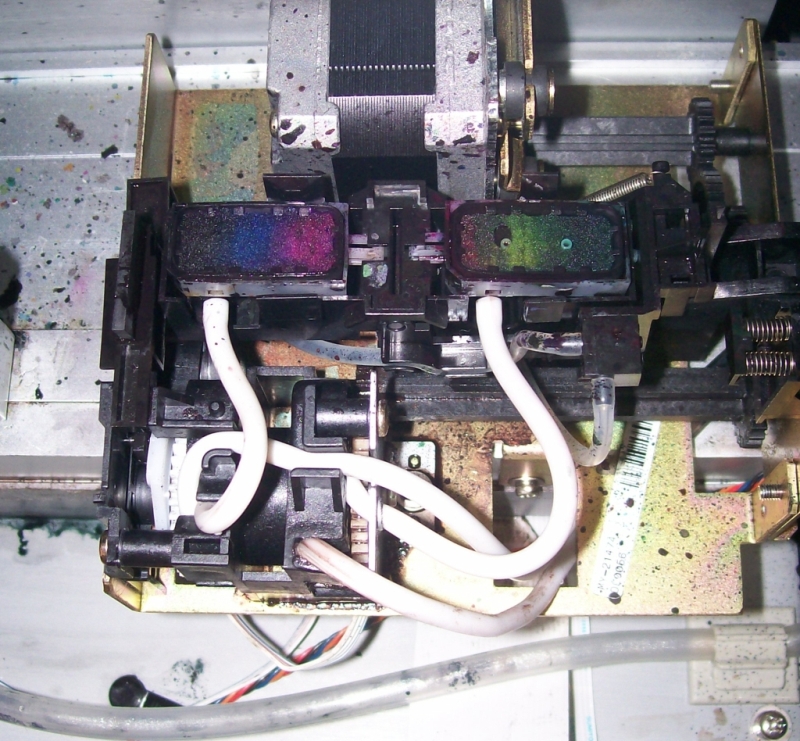

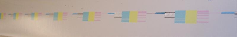

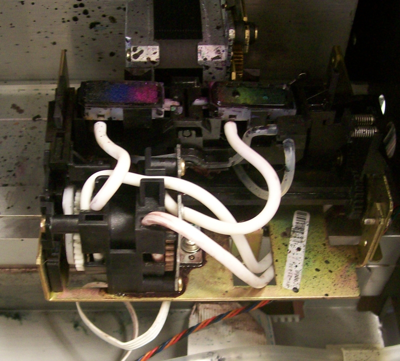

Images of capping station / nozzel check
Let me know if my hoses are even run in the right direction
Thanks

hoses all look to be in the right place.
If you have a syringe hook it up the the waste lines after it leaves the pump but before the gets the the waste bottle. Move the print head to the capping station, and see if you can draw ink throught the lines with the syringe.
Graphics2u
looks like in the second picture there is a puddle of ink around the bottom of th pump assembly. This could be a sign that the hoses are split inside the pump especially since those white hoses were the first ones they used and I have been told they don't hold up to the solvent well.
If you can get a short piece of hose, try to connect it right where the white hoses connect to the capping station and then try to pull ink through the head there. That way you are bypassing the pump and that will tell you if the pump hoses might be split.

the hose on the right side was split when i got the machine, i re-ran it and did the suction like you said, it pulled alot of air befor i finally got ink. i re-ran a nozzle check and it looked 100% better.
However my syrenge is not holding a vacuum, i ended up sucking on the hose to finally get a prime. moved alot of air, with very little resistance.
now im doing some test prints and the ink seems to still have solvents in it, because even after it has sat for 5-10 minutes i can smear it right off the vinyl and or paper. and it is cracking. Ill try and upload some pics soon
