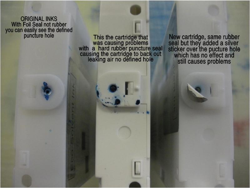

yeah we have the new (corrected inks) and they are no different exept a little longer and they have placed a silver sticker over the rubber seal on the outside...when the rubber seal is what I think is causing the problems
look at the cartridges and any feedback is welcomed....it shows all three cartridges and how the new ones really arent that much different
Pro photo :)
