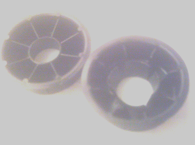

This is a bad photo, but these are the spools that come in some vinyl rolls and
ap tape. they are just a tad too small to fit over the poll, so, I cut away the
ribs around the center hole, then made 4 cuts at 90 degrees apart around the
center cylinder. It will spread just enough to hold pretty tight to the poll. Only
problem is you have to manually line up the edge of your media with the hole
in the pole where the leading flange fits.
