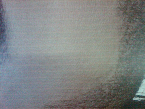

Unit Printing but Not Correctly
I now have the unit printing but not correctly. I have attached a photo of an image that I am trying to print. I have tried numerous cleaning cycles, soaking the head in cleaning solution.
Please help, I have been fighting this unit for over a week. Any advise would be greatly appreciated.

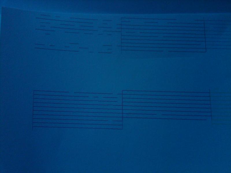

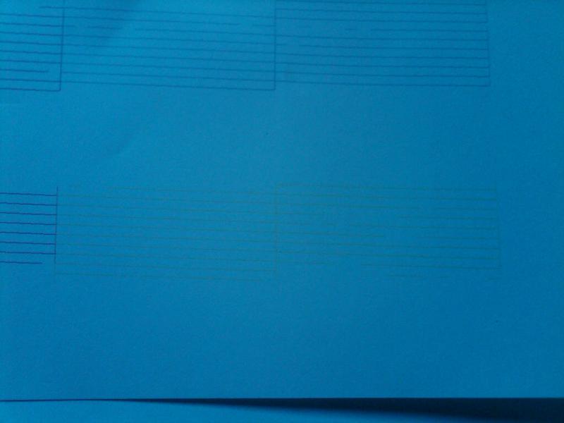

JC29669
Nozzle Check Attached
I have attached the nozzle check photo. Thank you for helping.

iladi
press the cleaning button. reprint a nozzle check. if it is not perfect, wait couple minutes and reclean. probably after that it will print perfect.
