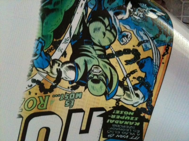

Ive attached a pic of what the original image looks like and what my print looks like.
Please take a look at the photos and let me know what you think!
Thanks!

Well, yellow will always be faint on white vinyl :) Do you have all the nozzles though?
If your yellow nozzle pattern looks pretty good, then....
try doing this... go into photoshop, go to the color chooser and and in the CMYK numbers, put in 0,0,255,0 (full yellow). Then draw a rectangle, say 50" x 2' (assuming 54" media), and fill it with the yellow.
Now save the PSD and then print it. Watch and see if your yellow starts to come back. You may have to print this numerous times to get your yellow back to normal
