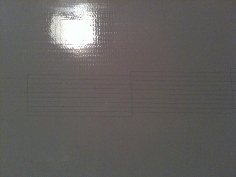

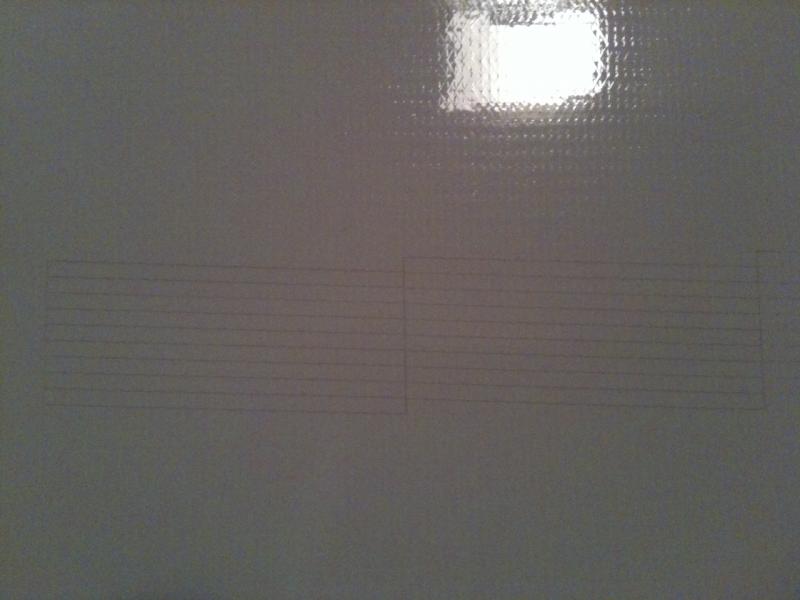

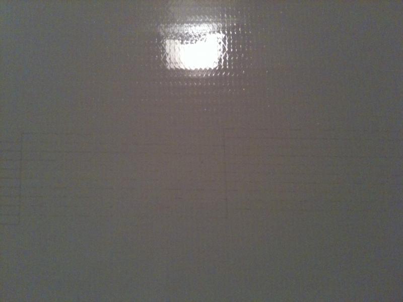

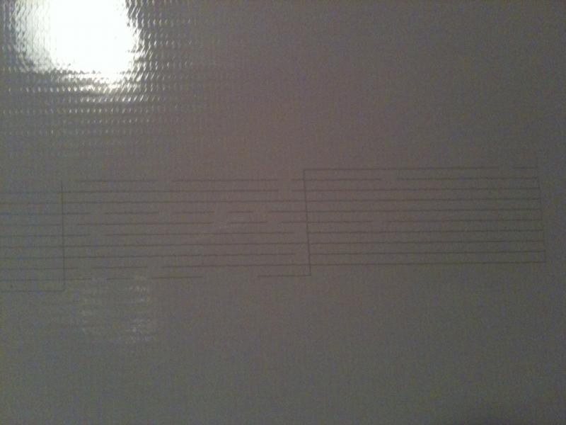

After running another cleaning and cleaning the wiper, I printed another nozzle check: Magenta is solid complete lines, Yellow is very faint and missing lines, Cyan is solid complete lines, and black is not terrible but is missing on a couple of lines.
I just need to know what I should do to fix the yellow and black. Cleaning seemed to help a bit, but I just wanted to get your advice before proceeding.
I attached pics of the nozzle check.

I tried the head soak today. I did it every 20 mins for about 2 hrs. After this, I ran a normal cleaning.
Now (of course) my yellow is running low. But I just ordered a cartridge.
Before the head cleaning the yellow nozzle check lines were broken and it appeared to have some black mixed in.
After the head cleaning: The yellow nozzle check has solid lines and no black. BUT the yellow lines are VERY faint.
Any feedback will be much appreciated. Thanks!!
