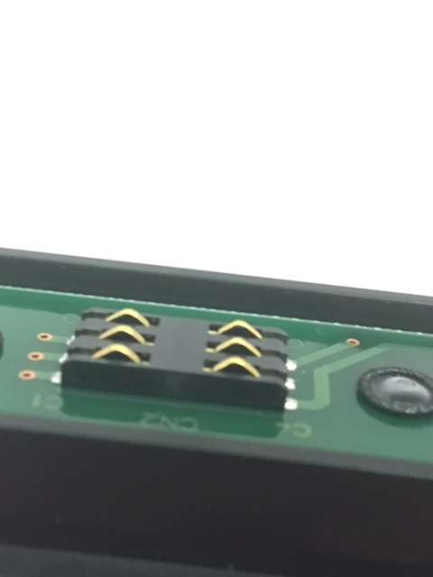

Out of curiosity, has the issue been resolved? I have had the same issue and the first thing I now look for when I receive the, KCMY (Broken Chip) error is to investigate the Ink ID Board Assemblies. They are the sensor where the ink chip makes contact and are being read for info, down at the bottom of the ink cartridge slot on one side. Check for any broken connections on the sensors and replace if necessary. IMG_3026.JPG

I have checked the Ink ID Boards as Picture above and they all seem fine, no broken pins.

If the chips work in another printer and all of the readers look good on the new one, the most likely culprit is the heater junction board. I just changed one recently for the same issue and it fixed it. Unfortunately the board is around $400.

Also the spring plates that hold the reader can loose their tension and need removed and bent back to shape.
I have had to replace the same one twice on my 1604 last week and even then on the last attempt the spring plate had dropped in wrong.
I still reckon it is something to do with the chip reader. Have you physically removed them and checked?
