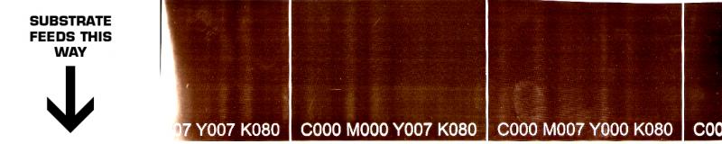

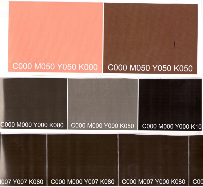

Here are a couple of photos of the banding:
The banding issue is less apparent in some colors. We have lost customers, and have comped orders due to the printer's output. Some of the prints come out okay, like I said -- it all depends on the colors. But even in the prints that are "okay" the banding is still there. A customer might not notice it, because they don't know to look for it. But I see it, and that is bad enough.

In all fairness, this looks like banner material, which should be run in high head height.
Vertical banding has a few possible sources,
The material itself, heater temps.
Vacuum from the fans, which can pull ink through porous media into the vaccum holes, which typically shows up in darker colors (heavy ink coverage).
Machine related vertical banding is typically bi-directional timing adjustments, but can come from machine damage, bearings, too much or too little lubrication, and I know of one machine that was on a wooden floor that set up harmonic vibration between the printer and the floor and gave weird print anomolies.
Bi-directional timing can be checked by running in uni-directional modes.
Banding only in certain colors can be profile related, effect related (try Fine and Wave 2 or Fuzz wave patterns), I have also seen interactions from diffusion patterns used in the RIP ( we typically use Random or Error diffusion patterns for the RIP, but the Profile MUST be made with the diffusion pattern up front, you cant change it later and get reliable and predictable results.)

We have ruled out the material, the problem is consistent across various substrates. I have gone through the full spectrum of heater temperatures, up and down all of them. The result is the same.
As for the fans, I think that might be a material-specific problem as well, also the bands don't line up with the holes.
We are running on uni-directional mode, in high head height. The banding is less apparent in low head height, however it is still present.
It is possible that we have machine damage, but if it is the bearings I can't even see them well enough to tell if they are damaged. I have un-lubed and re-lubed the raceways as well.
I've used all different wave patterns, and currently am using Super Fine and Wave B. This one shows the least amount of banding.

It might be heaters or print head related... Try the following print a 1 M x 1M square containing the following yellow magenta cyan and black all 100% remember not to mix all the colors to get black you just need to print black,, that is to test which color is giving you the headache.

Thanks for the suggestion! I have run that test before, a little bit smaller than a meter though -- that's a pretty giant area. I ran each color about 10 " high the full width of the roll with the same results across all colors.

What program are you using to create artwork and what RIP. If you take your pink color and match it with a PMS color (not making it a CMYK or a spot color), does it still have bands. If it only happens with certain colors it is not the printer but the way you have set up your print with your art program and RIP. For example if you take a color in Illustrator and turn down the % it will happen with certain colors.
