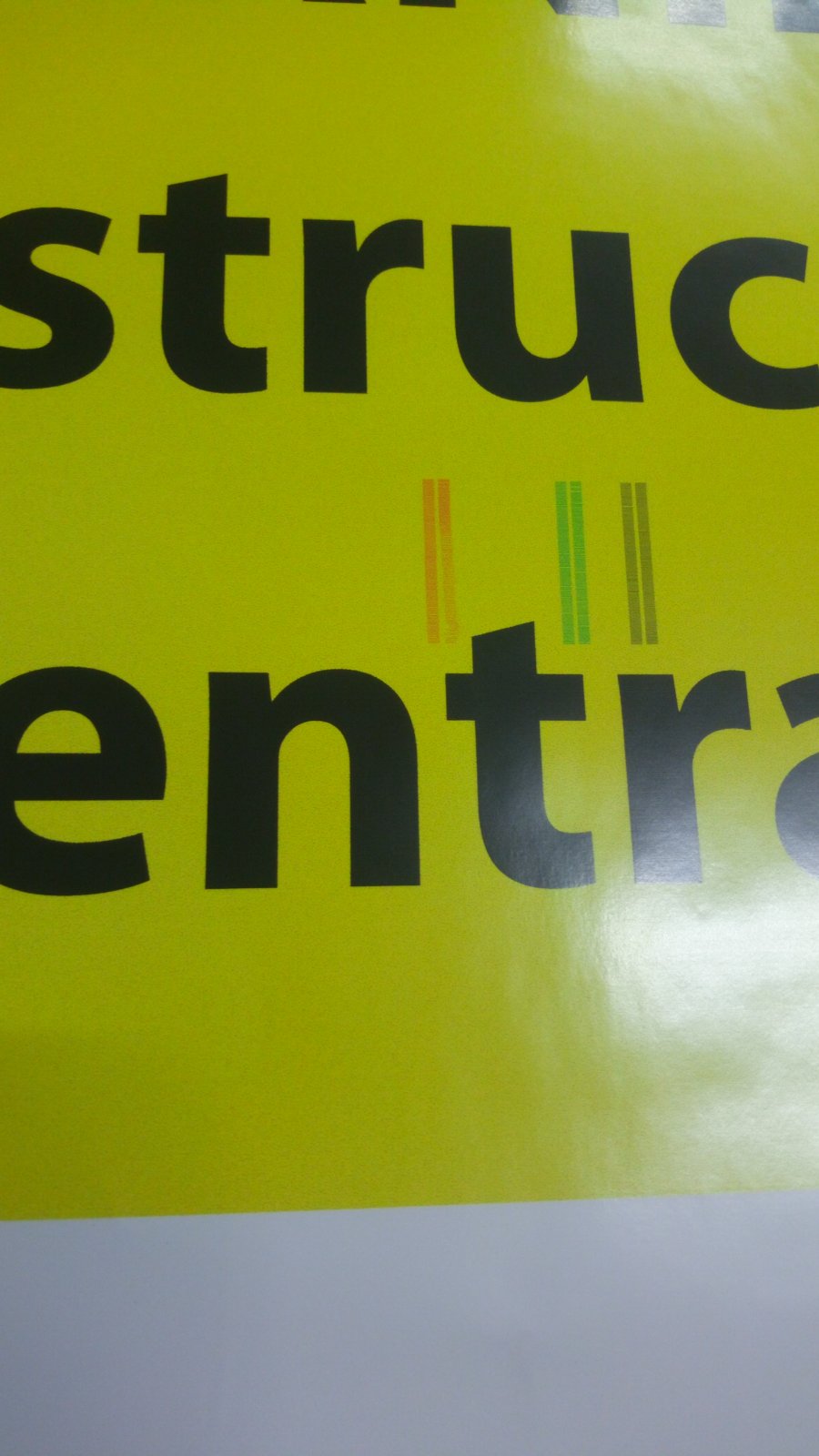

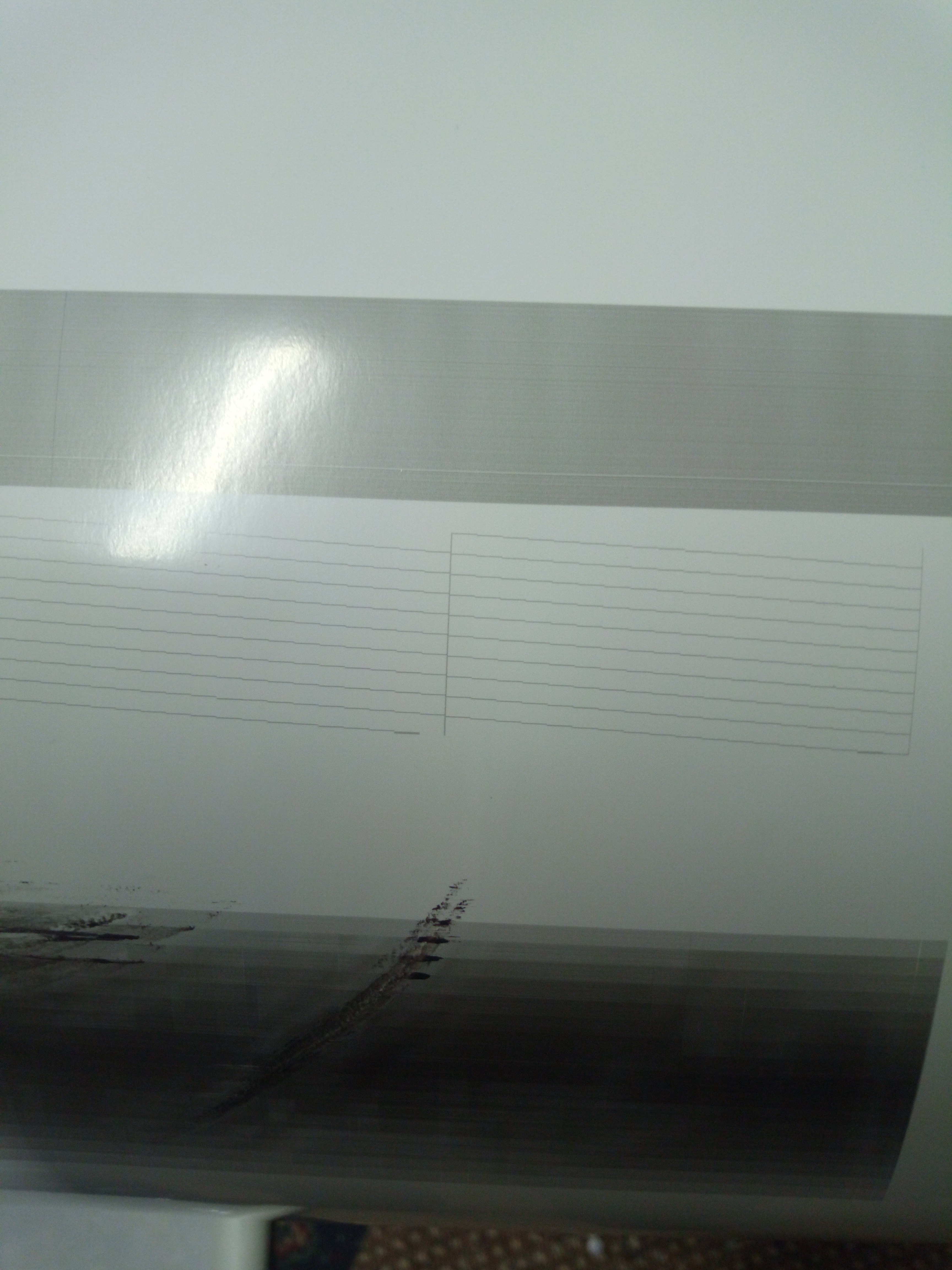

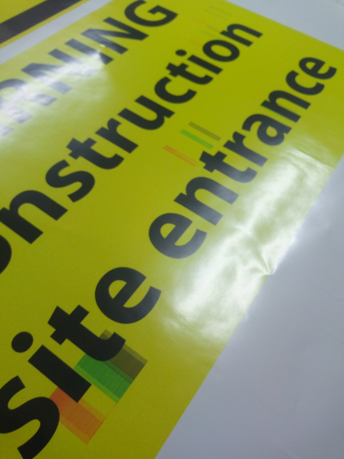

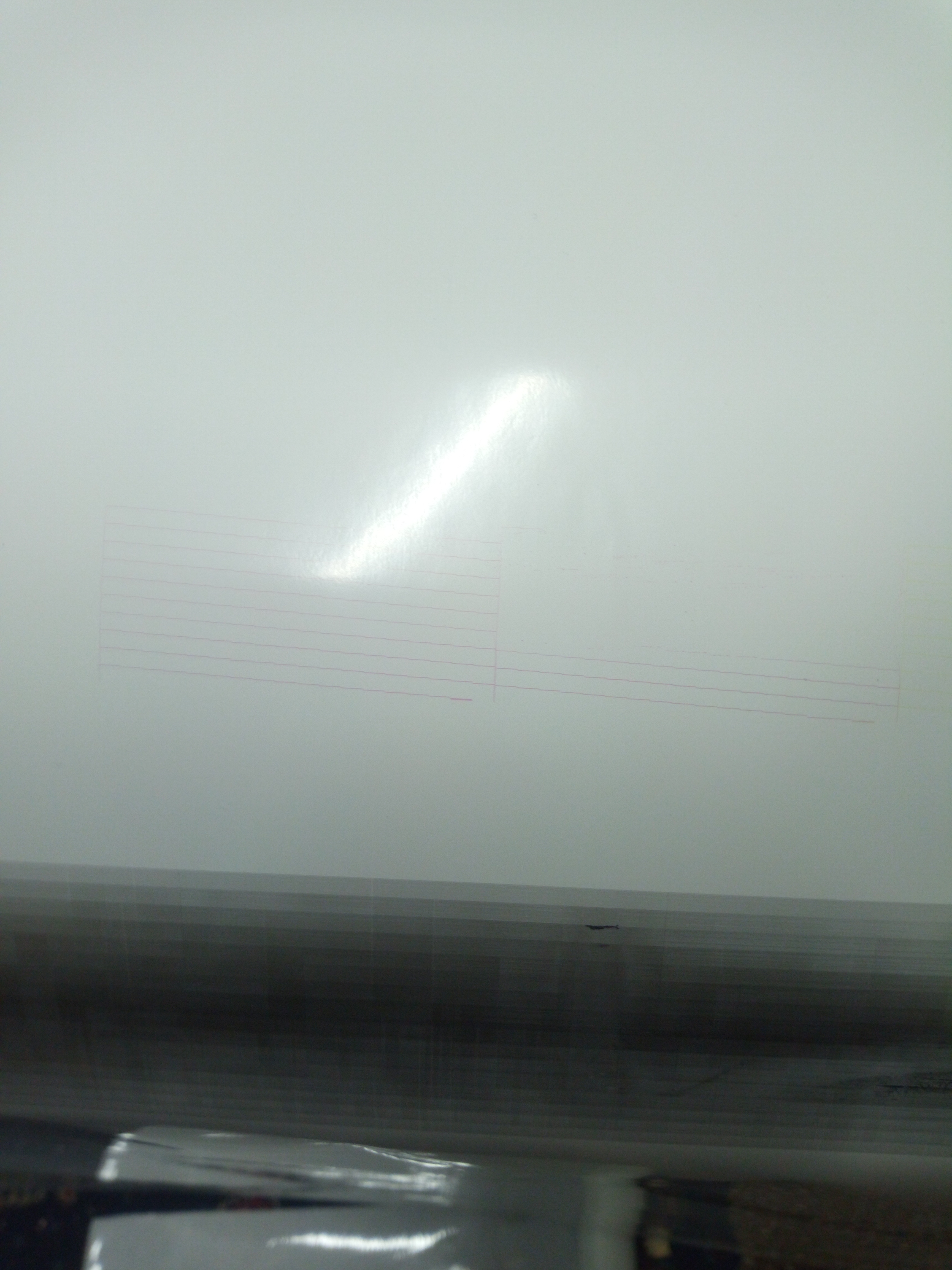

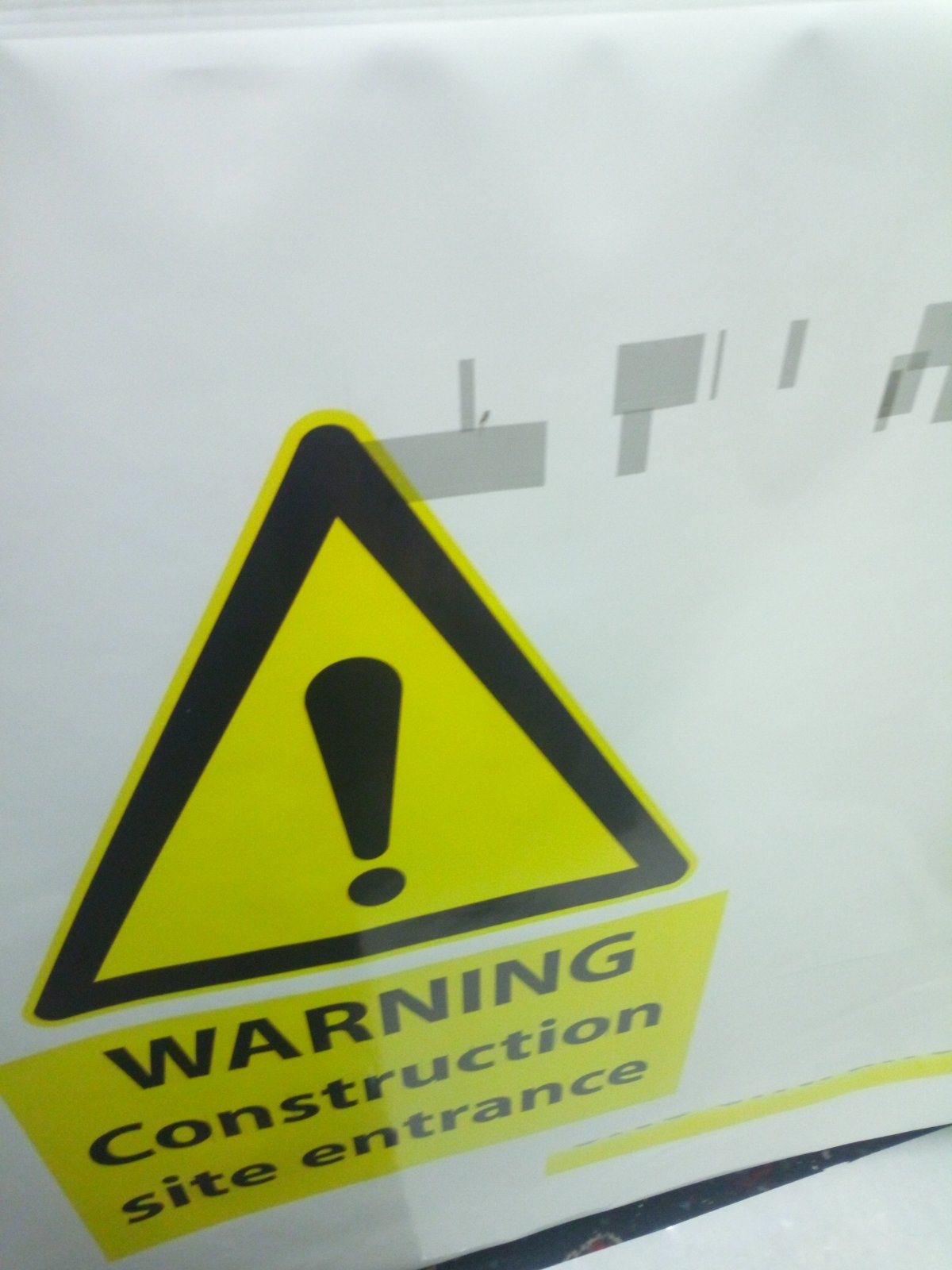

Hi, I have a VJ1204 and it started doning his today (see photos) and now its just printing grey, nossle check is all good, what can cause this?

Hi, Just to update so where it might help someone, we replaced the data cables from the print head to the control board and that cured it
Regards
