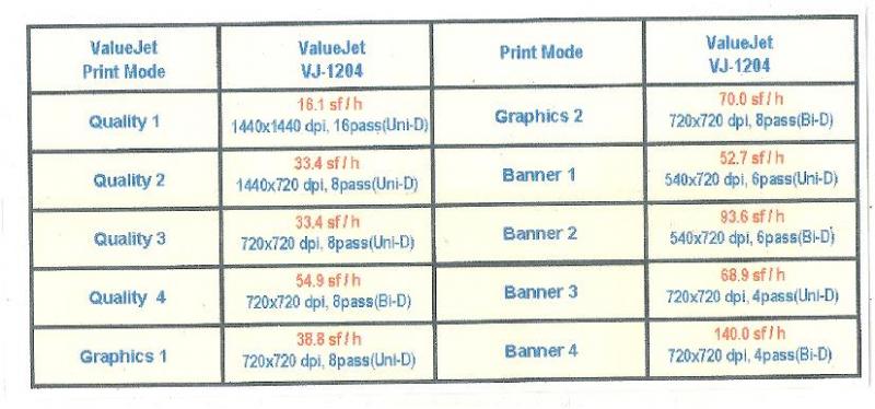

i think your printing in Bi-direction,and not Uni-direction. or vise versa....... try changing your print mode in PM. here are the Print Mode settings..........

Yeah, I always set the media width in the rip software, (I use Wasatch by the way) When the media is loaded it reads the width just fine. Unplugging or turning off the printer has no effect.
