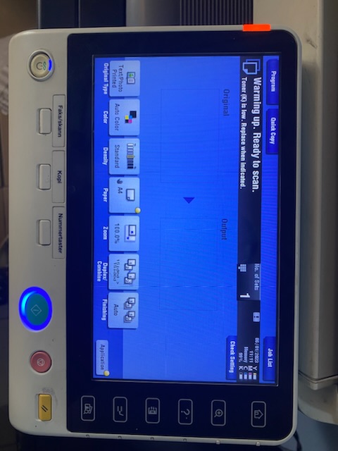

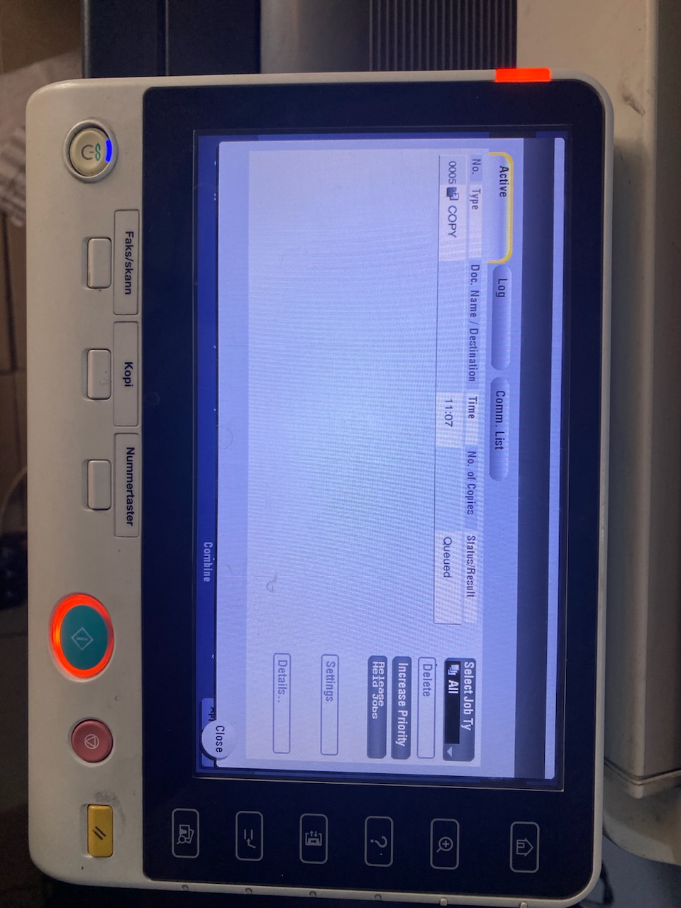

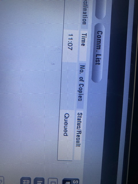

Hello my bizhub c754e wont print it is just stuck on Queue all jobs wont print. How do i fix this i tried so many things including wiping all datas on service mode and nothing. Please help its been two days and this thing wont print.

does it copy?
i assume things are in queue either because it is "not ready to print" (fuser not up to temp, toner not stirred) or because there is a "send job now" setting that is not checked.
you don't think it is set to use department codes, and not print without one?
or one of those "secure print" options GOD I HATE THAT FEATURE, people turn it on accidently all the time
it wants to be sure sender is standing in front of copier, entering a code.
