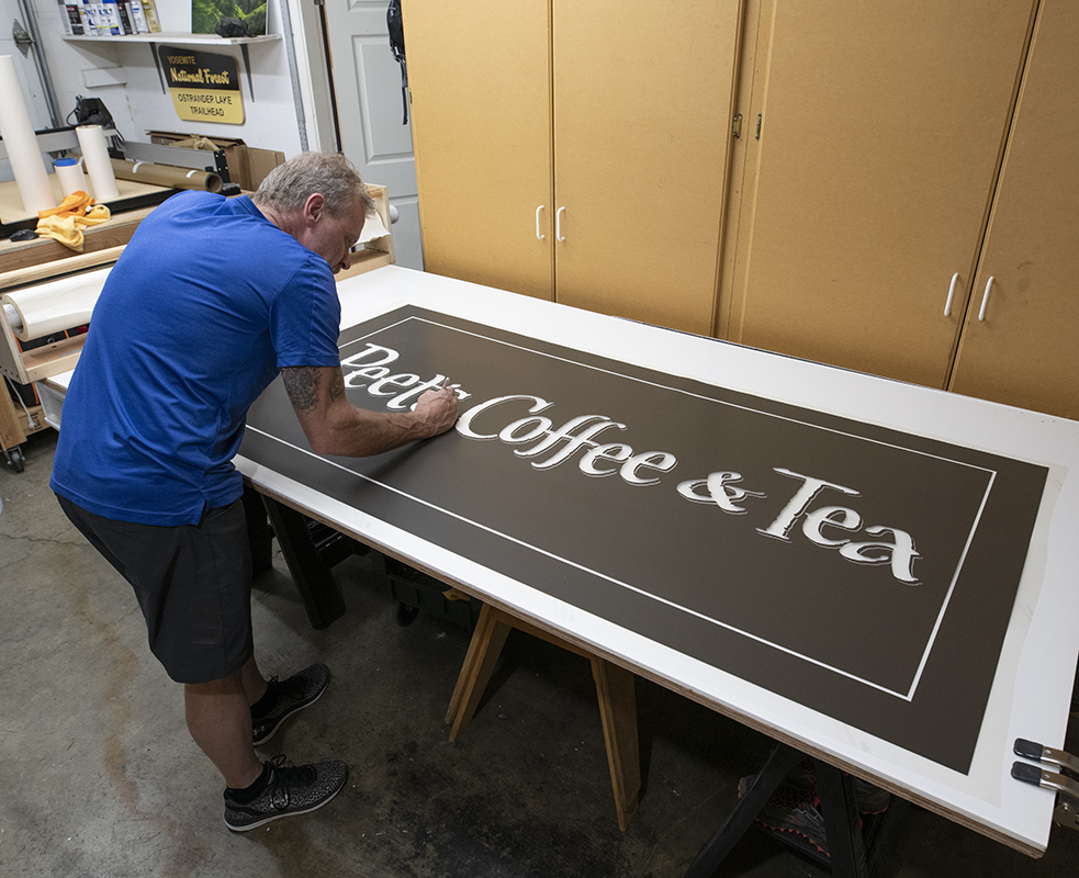

This is one of the smaller faces on this project.
