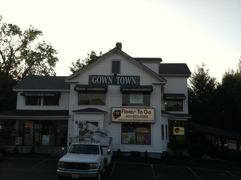

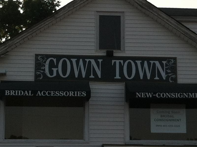

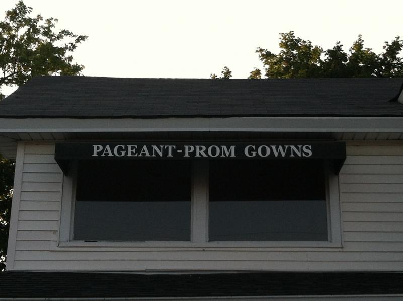

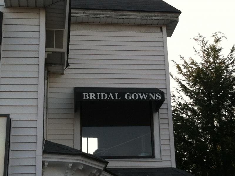

This was painted on black canvas awnings. I Used calendared Arlon vinyl as a stencil and outdoor latex paint, and a 4 inch roller. I think I did pretty good for my first time. Took me 5 hours to do the 4 awnings, and put up a new face on the 3x 14 foot sign on top, and letter a door (with a lunch break in there somewhere)
How much do you guys charge to paint lettering on awnings? I charged by the hour and for the gallon of paint that i used maybe a pint of. (didnt charge for vinyl stencil)
(i also refaced that "floors to go" sign in the picture a few months ago)
(also thought i would mention that the 2nd floor that is now "gown town" is where my shop used to be not long ago)
and 5 hours in a bucket truck with no sun block sucks!

I would have charged about $900.00 for the lettering thats DOES NOT include the awnings nor install. We letter a good bit of awnings of course most are now done with eradicated or sunbrella graphics system. Looks good to me

Little tight on air space for me, also would have used a sans font for contrast against name & easier reading against all other action.
How much bleed under ya get. ?
Done with in 10 hrs here 2 coats, no bleed, by hand, maybe less with lift

Yea I wasnt 100% happy with it, but to the average person it looks perfect.
There was a little bleed under, but not at all noticeable unless you were on top of it.
