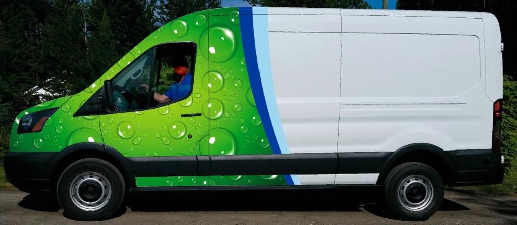

I am about to do my first wrap job (see attached.) What you see attached is what the customer wants. I have watched enough videos on wrapping I feel confident I can do the job but for this particular design I am scared when I get to the front and start going around some heavy contours the graphics will become distorted. Should I be doing graphics like this around heavy contours, I mean is it possible to do this without distorting the image or should I tell the customer to pick a design where some distortion won’t be seen?

that hcardwell93, i was talking about the transition from the side to the front hood. There is a 90° turn when i go to the hood. would this not be considered a heavy contour.? that is the area im scare of.

Shacho,
You should have a separate print/print file for the hood. I wouldn't have a panel where I was wrapping the side of a vehicle then try to take it to the hood.
  • Agree
Reactions: Bly
hcardwell93
Hoods, tailgates and roofs should be done as separate print panels.
The nice thing about the front of that van is you really dont have much metal where the fender can meet the hood so dont go crazy trying to make bubbles line up 100%.
Or if you do have a bubble element that's pretty prominent and you don't want to cut it off just lay the wrap on both panels, contour cut around that element and then place it on top of the other panel.

i have a 54" printer and the wrap is longer than that both ways. Would you suggest i put my panels vertically or horizontally?

we try and minimize the seams so doing it vertically is our go to approach using the door jams.
like the others have said, break it down into sections sides, roof, front, back, and on the sides break it down into sections based upon the door jams of the vehicle.
Since this is your first wrap, do you have an area in the shade / climate controlled garage to do the work in? make sure you avoid installation in direct sunlight. this will stretch the vinyl and cause distortion when you install.

Well, i am just about complete my first vehicle wrap. Its actually turning out quite good but i have run into a problem. I am wrapping a Ford transit van and on the side panel there is an indented area where a window would be on some models, but this model just has metal. So what i want to do is stick the bottom of the side then stretch it very tightly to the top to try to avoid it sticking in the indented area but i just can not stretch it tight enough to do this. So what i thought i could do is wet that area but i have read that you are not supposed to wet cast air release material. Has anyone used wet application on cast air release before or is this a no no. Anyone have any ideas on how to get around the indented area? I have attached a picture in my first post on this thread.

You're trying to make this harder than it has to be. Just squeegee it up the side of the van like normal. Then apply a little heat and push it into the channel.
