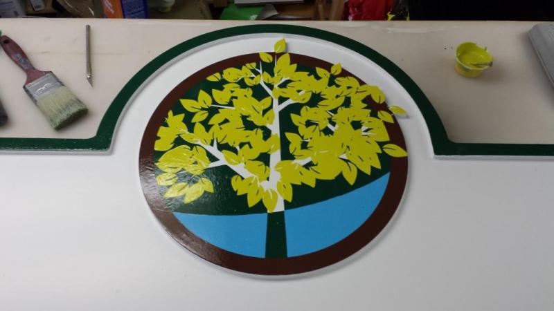

Here is the logo.

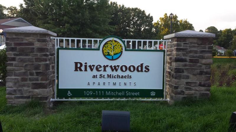

And Installed. The fence section is one that I had made from 3/4" solid alum bar, custom fabricated, and then powder coated white. the ends are attached with a custom made bracket that I came up with. It is a piece of tubing welded to a flat bar, the fence slides into the tube, and bolts in with stainless steel hardware.

Here is the logo.
