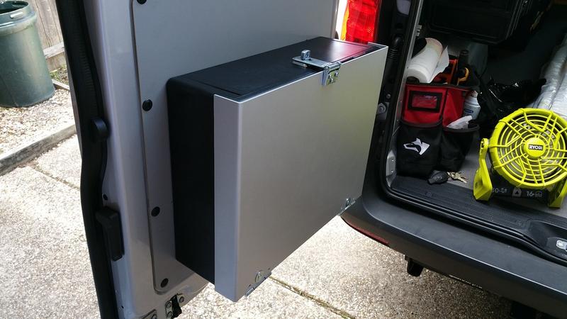

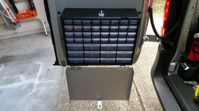

Put a couple of parts organizers on the rear doors for screws, anchors, studs, spacers, etc.

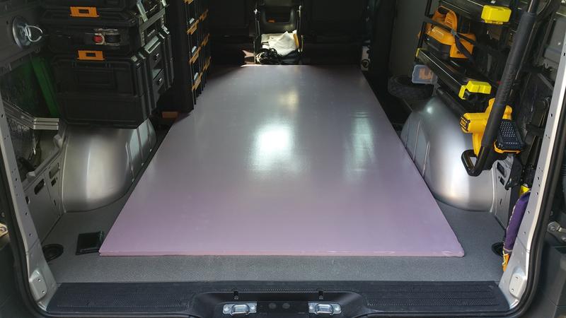

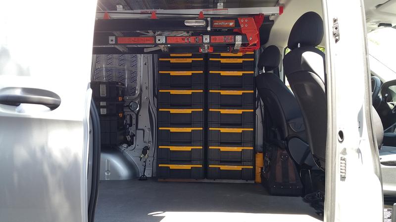

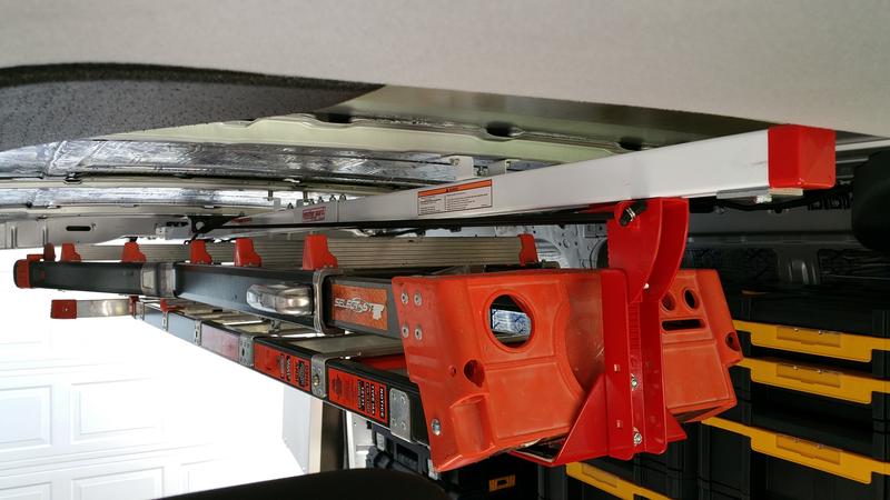

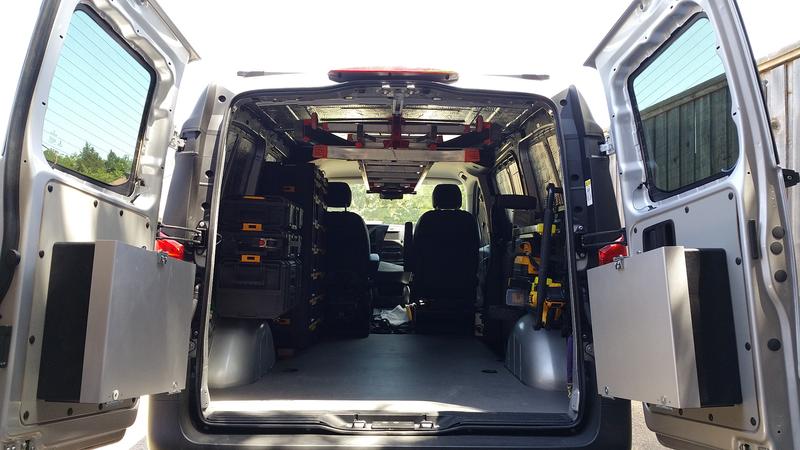

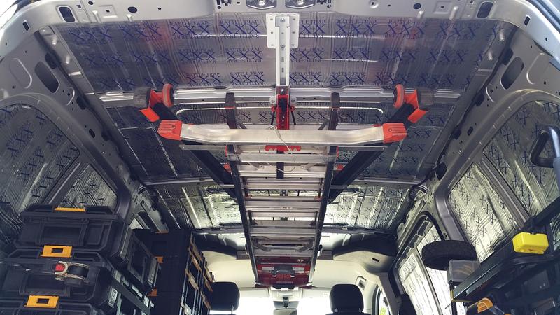

Installed a roof-mounted interior ladder rack so the floor is pretty much completely clear and able to accommodate 4'x8' sheet material.

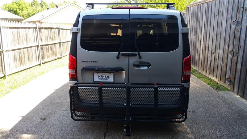

Moze

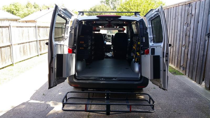

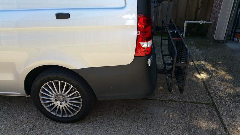

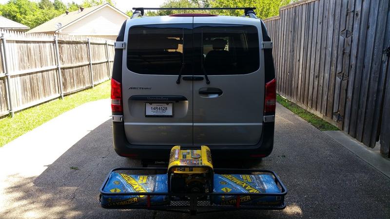

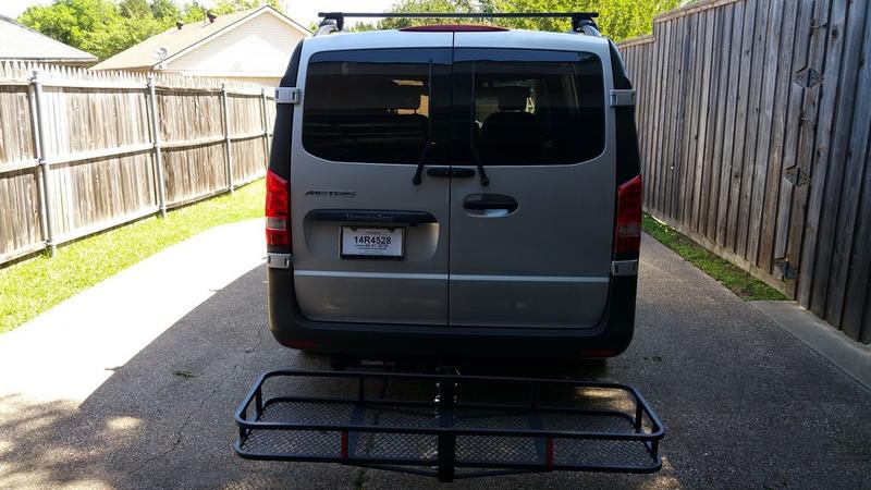

Added a cargo carrier for times I'm installing post-mounted signs. I can carry six bags, which is enough for three holes (normally only do two at the most) and the generator. Mainly added this so I didn't have to carry the concrete and generator inside the van.

With the addition to the insulation / sound paneling helped with heat and road noise?
Not sure about heat but it's definitely helped with the road noise. Before it sounded like a rattly tin can. Now it sounds like a muffled tin can. :)

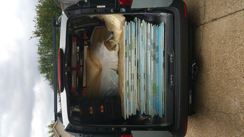

Can't help but sing the praises of this van. The max payload capacity is advertised as 2,502 pounds.
Picked up forty-five sheets of ½" drywall at 51 pounds per sheet equals 2,295 pounds. About 75 pounds of insulation and 75 pounds of tools and a 50 pound ladder brings it to 2,495 pounds.
The van barely squatted and still handled and braked really well.
Love this thing.

The boxes behind the drivers seat are DeWalt Tstaks. Boxes over drivers side wheel well are DeWalt Tough Boxes. DeWalt Tough cart is over the other wheel well. Roof-mounted ladder rack is a Weatherguard, purchased off Amazon. The parts organizers on the rear doors are off Amazon. Roof rack is factory, cross bars are off eBay. I installed everything.
