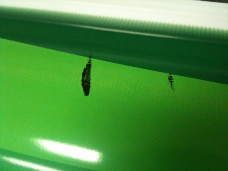

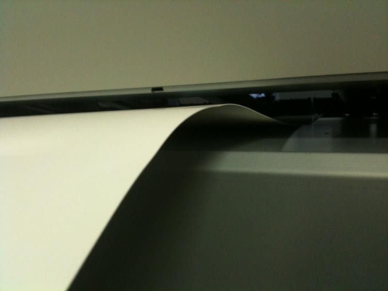

I was wondering if anyone knows why my 1304 and my 1614 keep lifting in the back to one side then head striking? I have been trying different things to fix it and have had know luck. Here are some pics to show you what happening

What material? Are you unrolling any slack from the roll before printing?
*** Here is a pic for all to see
CS-SignSupply
Sounds like the core in the roll may be out of round and can cause the roll to get loose or unwound looser on one end...

I do notice it happens on different rolls, some I can run 1800 inchs no prob others it happens after several hundred inches. It will also lifts in the back that I get the end of roll error when it left off the sensor.

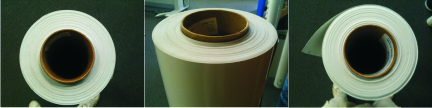

I doubt it. The next time you notice it, take a picture of each end of the media, showing the ends to see if one side is slightly more unraveled than the other...
GrantX01
Here is a pic of another roll I have they all look the same to me I have about 6 I house now
