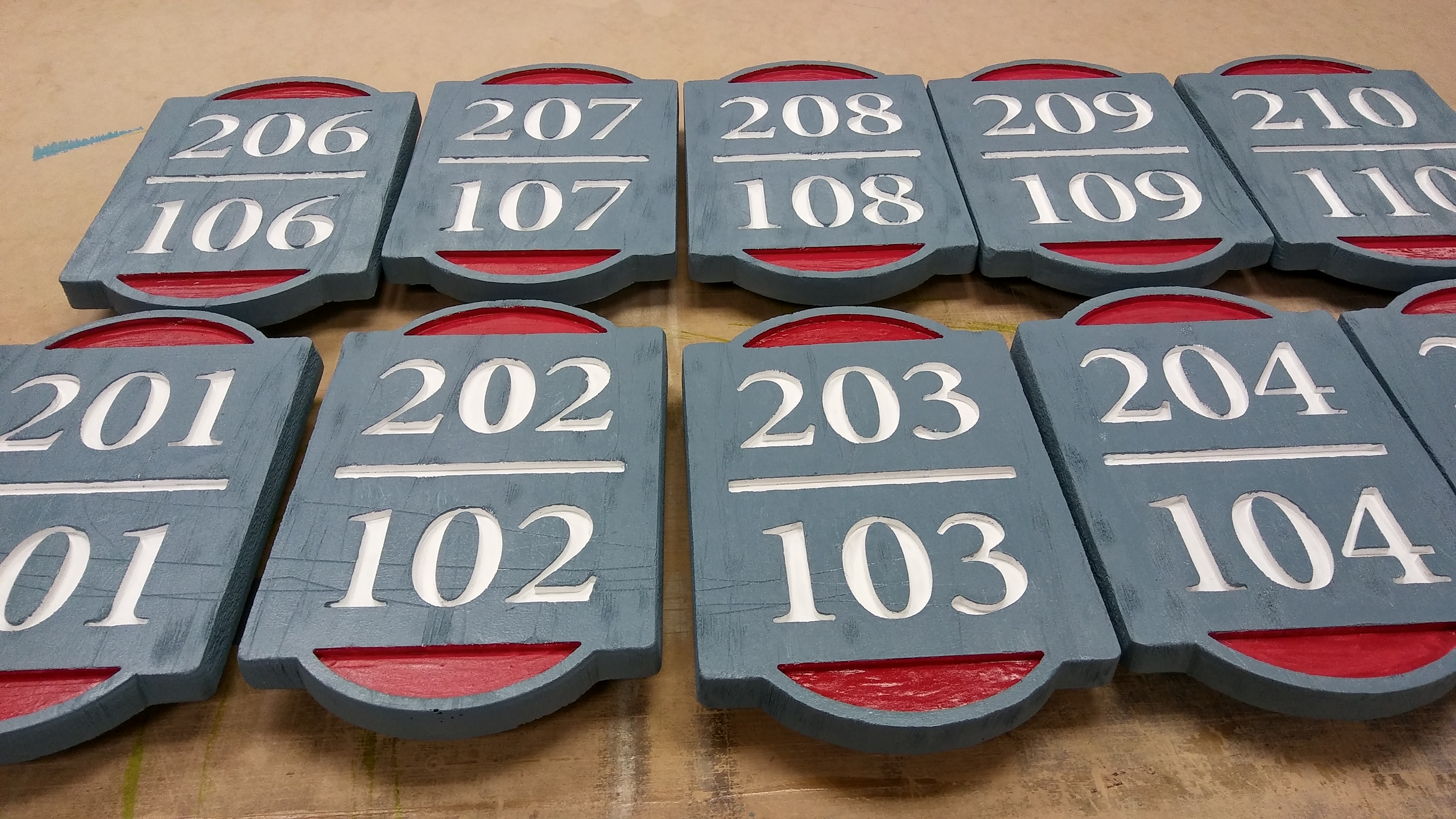

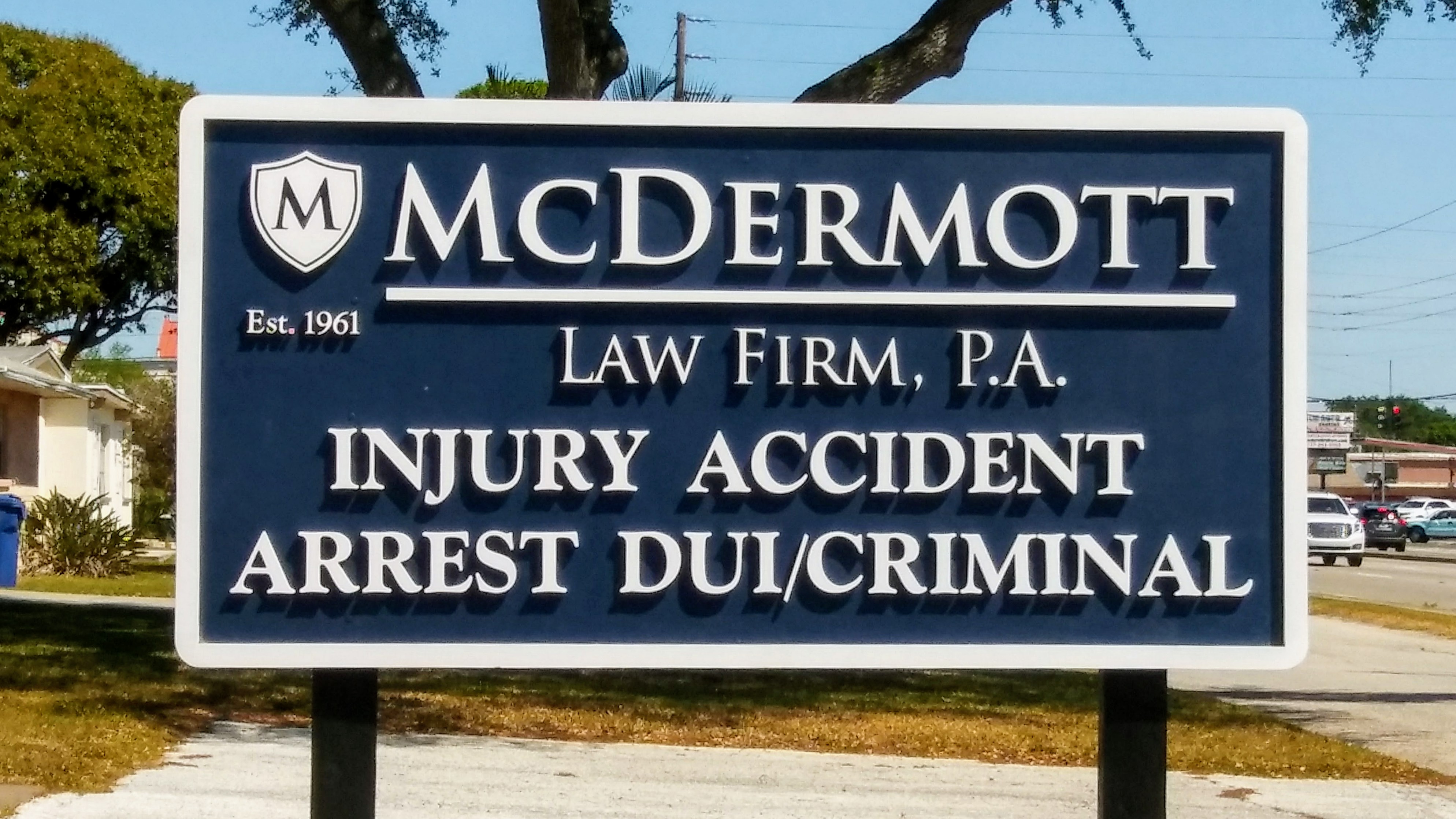

I had forgotten about this post. Good to see it come up again. A couple of photos of jobs done with my Shaper. All done using H.D.U. Also...Gorilla glue works great for gluing foam together, I recommend using the "clear" gorilla glue because it doesn't foam up like the other one.

^ The law firm sign looks good; the address plaques look like hell. Why did you not fill the scratch marks in the material? Between those and the drips into the lettering, that's about as rank amateur as it gets. If I was your customer, I would have never accepted those.

I probably shouldn't have included that photo. The plaques have a woodgrain, weathered look that just didn't show in the photo. Customer was very pleased.
